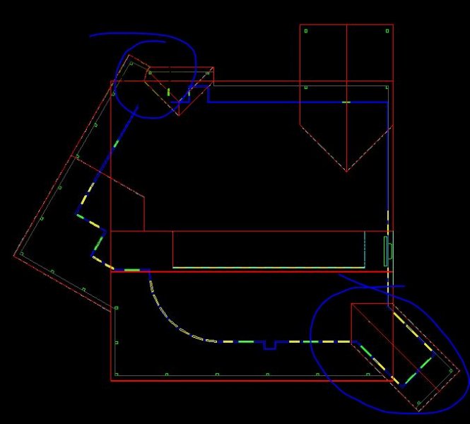

HerkSmith Posted October 8, 2012 Posted October 8, 2012 I am trying to use AutoCAD 2013 to create a complicated roof. What is the best way to extend 3D solid roof planes and to trim 3d Solid roof planes that intersect each other? I have tried slicing and can't quite get the hang of it! 12053-XREF-01-0A.dwg Quote
ReMark Posted October 8, 2012 Posted October 8, 2012 You might try using the Slice command with the Surface option. Quote
HerkSmith Posted October 8, 2012 Author Posted October 8, 2012 Converted the 3d solid roof planes to a surface, and tried to slice out the offending roof planes, but no dice... Quote
ReMark Posted October 8, 2012 Posted October 8, 2012 I would have left the roof a solid and sliced it using an extruded line (surface). Quote

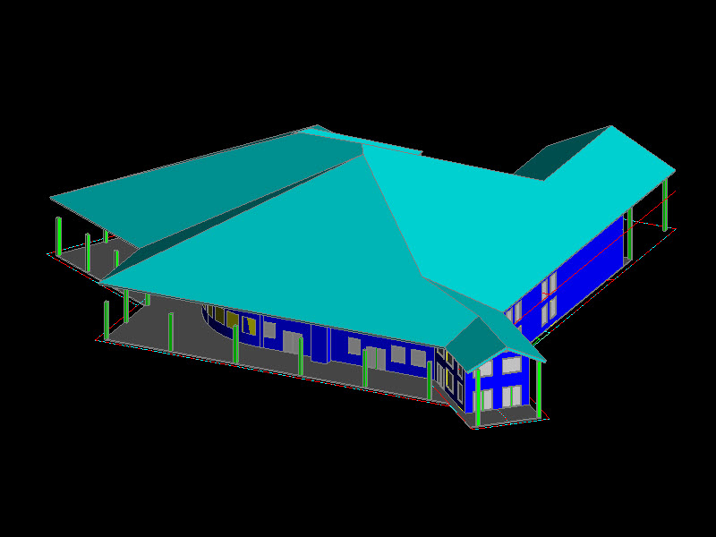

kencaz Posted October 9, 2012 Posted October 9, 2012 Here is what AEC's Roof Tool came up with based on your general roof plan layout. The only thing I modified was add the two gable ends. At least you can see how your roof valleys and hips need to join up... Good Luck!!! KC Quote
HerkSmith Posted October 10, 2012 Author Posted October 10, 2012 KC - Thanks for the help! There are some exceptions to the roof to the one you've provided I have to honor...when done I will post. Quote

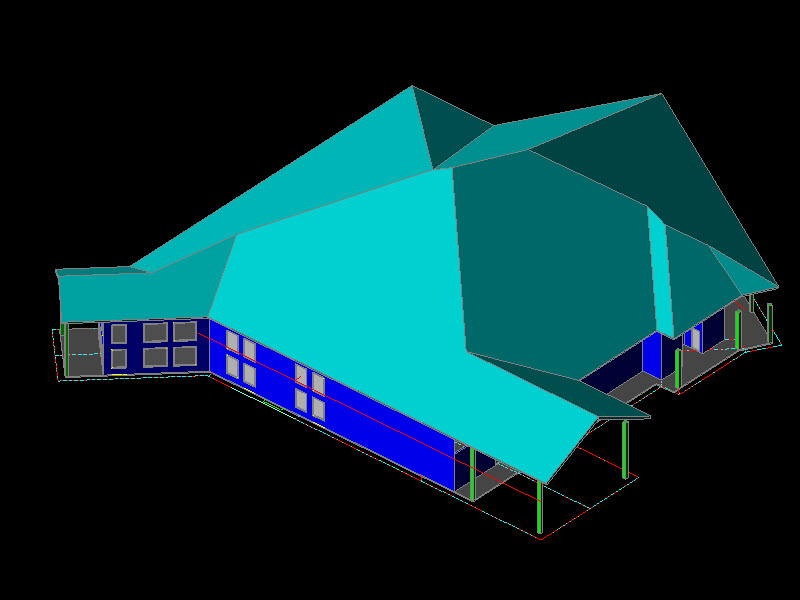

samchums26 Posted October 10, 2012 Posted October 10, 2012 your roof will be like this as per your roof plan. 12053-XREF-01-0A.dwg Quote
HerkSmith Posted October 10, 2012 Author Posted October 10, 2012 Great job! Thanks for the help, and for plugging the holes! When I am done rendering I will post. Quote

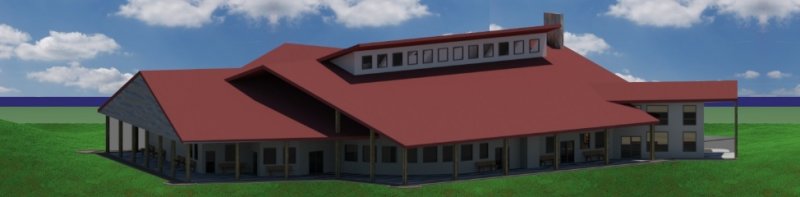

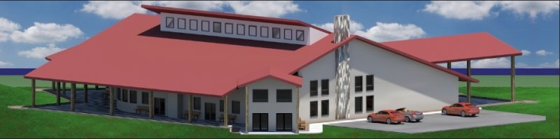

HerkSmith Posted October 12, 2012 Author Posted October 12, 2012 First foray into 3D modeling and rendering, including photoshop for the grass and background. Thanks for your help! Quote
