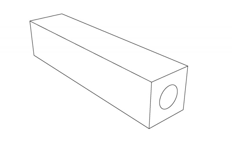

I would output to an image file and use that rather than screen capture if best possible resolution is desired.

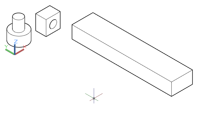

Here is what I got...
Set facetres to 3
and set displish to 1
I printed to a PDF and in the Print dialog box I set my Shade Plot to legacy hidden. I opened the PDF and then saved it as a jpg. I also changed to perspective from parallel but that does not affect this smoothness of the plot.
A big thank you to everyone. I am now able to produce great looking drawings with a smooth output.
