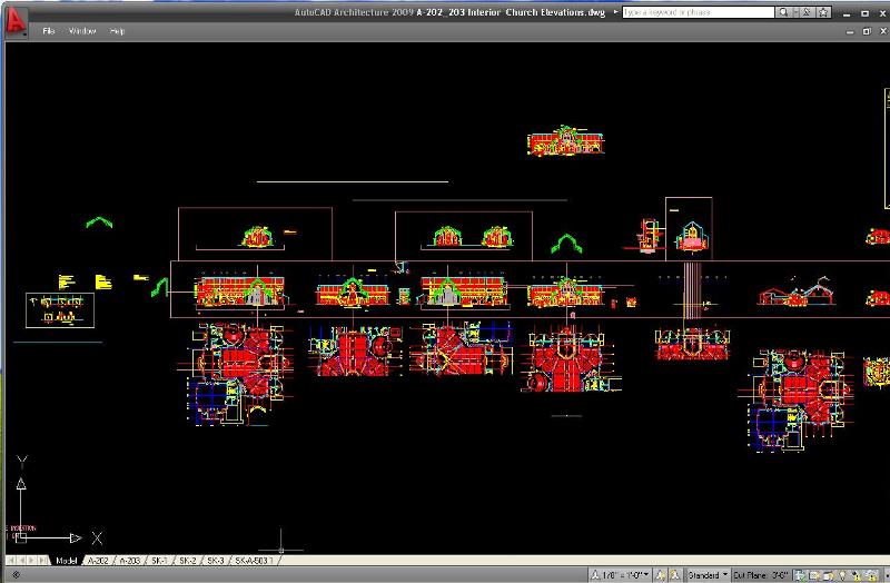

wings Posted October 5, 2012 Posted October 5, 2012 Someone here at the office started up autocad and the only things that showed up were "File", "Window" and "help" in top menu bar are the only things that show up. Where did the rest of the tools and camands go, and how can I get them back. Autocad 2009 for this. See below. Quote
ReMark Posted October 5, 2012 Posted October 5, 2012 In AC 2009 is there a "Clean Screen" button waaaay down in the lower right hand corner? Maybe it was punched by mistake. I just checked 2007 and it has a "Clean Screen" button so you should see it too. Quote
wings Posted October 5, 2012 Author Posted October 5, 2012 ReMark said: In AC 2009 is there a "Clean Screen" button waaaay down in the lower right hand corner? Maybe it was punched by mistake. I just checked 2007 and it has a "Clean Screen" button so you should see it too. Nope. Did not do it. Quote
wings Posted October 5, 2012 Author Posted October 5, 2012 ReMark said: Do you have a command line? Yes, and currently it's useless - not able to accept commands. Quote
ReMark Posted October 5, 2012 Posted October 5, 2012 Have you tried shutting down the computer completely, rebooting then starting up AutoCAD again? Quote
wings Posted October 5, 2012 Author Posted October 5, 2012 Yes. Multiple times. Was working fine yesterday. Quote
ReMark Posted October 5, 2012 Posted October 5, 2012 Yeah, that's what everyone says. AC 2009 on a Win7 system. Is this a 64-bit system? If yes, are you running in XP mode or using another piece of software like LongBow? Did you try the REPAIR option yet? Quote

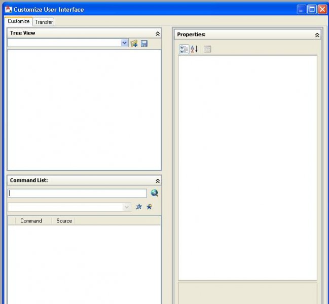

tzframpton Posted October 9, 2012 Posted October 9, 2012 Just re-apply your Workspace to Current. Type CUI, under "Workspaces", right click the one you use most and click "Set Current". Quote

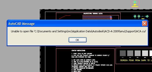

wings Posted October 10, 2012 Author Posted October 10, 2012 StykFacE said: Just re-apply your Workspace to Current. Type CUI, under "Workspaces", right click the one you use most and click "Set Current". I can't type anything. I get this error message, and the following screen: Quote

ReMark Posted October 10, 2012 Posted October 10, 2012 That means there's a job opening? LoL Well it sort of looks like ACA.cui is missing or the path to it has been messed up. What do you think? Quote

tzframpton Posted October 10, 2012 Posted October 10, 2012 Hmm, you should still be able to type in commands. Ctrl+9 doesn't give you the Command Line window? It should still be there, and typing CUILOAD can load the CUI/CUIx file that you need. Quote
ReMark Posted October 10, 2012 Posted October 10, 2012 Styk: You are assuming the CUI file is not missing. Quote
