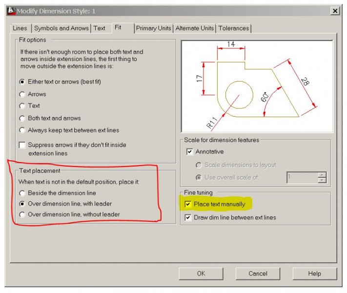

I suggest that you choose whichever text position you are most likely to use as an alternate position, either over dimension line, with leader,
or over dimension line, without leader, then check Position Text Manually. In that way relocating your text is quite fast, with the dimension line,
and as rkent mentioned you can set it to default with or without a leader when you stray from the normal text position.
In that way you only need to use the dynamic grip hover menu when you choose the least likely option for it. :)
