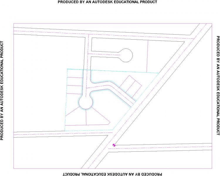

abysmalfall Posted September 29, 2012 Posted September 29, 2012 Hello, I've found this site extremely helpful.....and PennFoster not so much. I was wondering if someone could critique my drawing?It "looks"like the other drawings i've seen (for the most part).It is roughly 50% complete. Please and thank you. Quote

ReMark Posted September 30, 2012 Posted September 30, 2012 No, it is not the preferred method for student drawings for Penn-Foster. Why? Because any other student can "borrow" your drawing and pass it off as their own. Just think of all the work you just saved someone. The issue may have had something to do with the angle type you were using, the angle used to denote East, or the way you were entering the distances. Since we were not by your side watching what you were doing at the time we have no real idea what the problem was. The linetype for the street centerline and the property line shouldn't be the same. I don't agree with the way you have the sidewalk, curb and "parking strip" shown. As a matter fact I think Penn-Foster does not provide the student with the correct information for laying this out. Quote

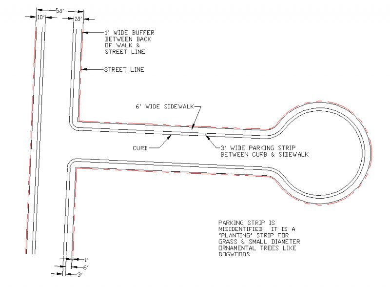

ReMark Posted September 30, 2012 Posted September 30, 2012 (edited) I have yet to find a town or a city where the sidewalk, curb and "planting" (not parking) strip fall outside the streetline. They always fall inside the streetline. And it is called a "planting" strip because in most towns/city that's where one will find trees planted along the roadway. The project was slapped together without much thought as to what happens in the real world. You might want to remove the DWG file in post #3. I will take a closer look at your drawing on Monday morning and post any further comments to this thread. Good luck and good night. Edited September 30, 2012 by ReMark Quote

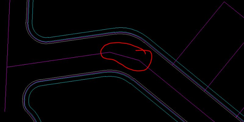

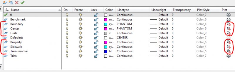

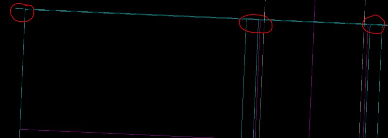

ReMark Posted October 1, 2012 Posted October 1, 2012 (edited) 1. You have a block named "ReMark Tree" at 0,0,0 that is very, very large in size. Delete it. 2. You have six layers set to "no print" in your Layer Properties Manager. Why wouldn't you want these particular layers to print? See below. 3. Your linetype scales are such that something like the "center" linetype does not display correctly. You will have to change your linetype scale. 4. There are two lines where there should be only one. See below. 5. The centerline of this road should be a curved line (arc or section of a circle) and not a straight line segment. See below. 6. You had only one tree block inserted and it was in the wrong place. Where are your other trees? Alright, that's my quick review. Edited October 1, 2012 by ReMark Quote
ReMark Posted October 1, 2012 Posted October 1, 2012 If one goes to the Penn-Foster website they will note that the Student Services Center is located in Scranton, PA. I visited the city's website and under the General Code found the following. Section 412-8: Street width not less than 50 feet fence line to fence line. Section 412-9: Sidewalk width of not less than 5 feet. Planning and Zoning calls for a local road to have a width (street line to street line) of 50 feet with a "cartway" (meaning the paved portion) width of 26 to 32 feet. It also points out that "sidewalks shall be located within the right-of-way". The right-of-way is defined as that area that falls between the street lines. Apparently Penn-Foster is not even in conformance with the rules and regulations of the city its Student Services Center is located in. What a bunch of idiots. Quote
ReMark Posted October 1, 2012 Posted October 1, 2012 This is the correct way the curb, planting strip (not "parking" strip), sidewalk and buffer should be laid out. The street line width is 50 feet wide and the paved roadway is 30 feet wide. Anyone at Penn-Foster who tells you differently does not know what they are talking about. You can point out to them that their own instructions call for the "planting/parking" strip to be between the sidewalk and the curb. It's on Page 7 of the instructions. Quote

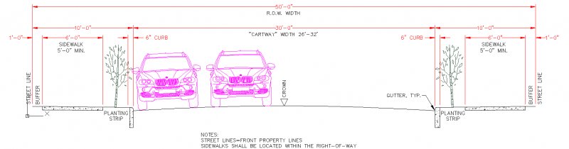

ReMark Posted October 1, 2012 Posted October 1, 2012 This is a typical 50 foot wide street cross-section using Penn-Foster's own criteria of a 1 foot buffer (between the back of walk and the street line) and 6 foot wide sidewalk. Curbs are generally 6 inches wide. The layout I have pictured allows for a vehicle parked on both sides and still accommodates two way traffic. You can tell your instructor they can visit CADTutor and this thread to see a typical street cross-section done correctly. Quote
