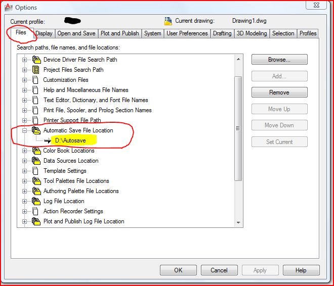

Good idea!!! I thought that I had set that already, BUT, it obviously did not happen. I definitelly have to change that for sure, thanks for the good, basic advice! :)
This is how you do it in 2012, then you BROWSE to wherever you want it to be saved to set the path.

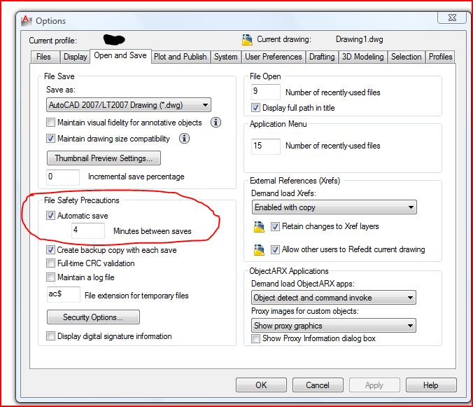

You also need to set the frequency with which autosaves are created, and this is how it is done in 2012.
