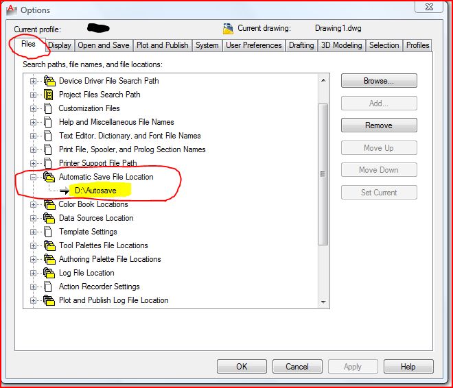

Like nod said, if you do not have the .bak file to use (by changing the name from .bak to .dwg)
then you should check in your AUTOSAVE folder.
I am guessing it is still there, but you need to ZOOM >EXTENTS.
If you don't know where to find your AUTOSAVE folder, then look at the image,
to find out where it is on your system.
Edited by Dadgad
