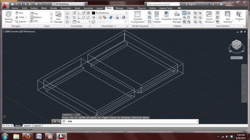

Can I make an object like the one I drew and then adjust the lengths of its various faces to whatever values I like?
If so can you point me in the right direction please?

Have you tried Presspull command?

Presspull or if you want to go old school Extrude Faces
Yes I tried to push pull but I want to be able to know how long my faces are so I can push or pull the face exactly the distance I want.

Take a dimension? If you drew it, don't you know how long the faces are?

Explore all of the controls which are circled in RED on the ribbon in the image, they could all come into play,
depending on how you chose to do it.
You may want to turn on your DYNAMIC INPUT too.
PRESSPULL is great for fast and loose, pushing holes through pieces and such, but lacks the direct dimensional input that you are talking about.

Command: _solidedit
Solids editing automatic checking: SOLIDCHECK=1
Enter a solids editing option [Face/Edge/Body/Undo/eXit] : _face
Enter a face editing option
[Extrude/Move/Rotate/Offset/Taper/Delete/Copy/coLor/mAterial/Undo/eXit] : _move
Select faces or [undo/Remove]: 1 face found.
Select faces or [undo/Remove/ALL]:
Specify a base point or displacement:
Specify a second point of displacement: 35

issue Presspull command
pick a face then move your move, then enter the required press or pull distance
Ctrl select face, then....
Sounds like what you need first is Measure or ID or Viewbase and dimensions.
