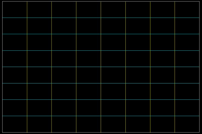

ReMark Posted September 27, 2012 Posted September 27, 2012 Nice explanation and a good graphic to go with it. If that doesn't get the point across then we're back to square one. Quote

edwinprakoso Posted September 27, 2012 Posted September 27, 2012 ReMark said: Alright I'll bite. What is the benefit of having more than the maximum number of viewports if they all can't be displayed? The most viewports I've had in a single "D" size drawing has been 20. I could not imagine a situation where I would need 64 let alone more than 64. LoL 64 viewports is the limit for displaying contents, but you can have more for printing purpose. If you have more than 64 viewports, once you activate blank viewport, it will display the content and AutoCAD will randomly turn off another viewport. You can lower the limit too. I forget the sysvar name. I think this limitation is for managing system memory. Quote

edwinprakoso Posted September 28, 2012 Posted September 28, 2012 ReMark said: I keep wondering. If I have a layout and it has 100 viewports and only 64 can be active at one time then I can't see what's in the other 36. So I make those active instead and now I can't see what's in 36 different viewports. Does this sound productive at all? And what's this "plus" about being able to print them? What if I really needed the contents of all 100 viewports printed at the same time? Who thought this was a good idea? Anyone else using more viewports than me? More than 64? Probably I didn't explain it clear enough. You can print all viewports and all their contents. Doesn't matter how many viewports you have. AutoCAD limit 64 visible viewports just to limit video memory usage. I believe this is a legacy feature. When we don't have more than 1GB video memory. If we have quite large amount of video memory, then it probably doesn't matter if you display hundreds of viewports. Not many people use more than 64 viewports anyway. I have more for several drawings, but less than 10% of my whole drawing productions. You may want to check MAXACTVP variable. It has range 2-64. Try to lower it to 2 and see what happens. Quote
