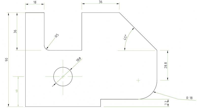

Young Zinjy Posted September 25, 2012 Posted September 25, 2012 i'm new to to AutoCAD as im studying civil engineering in my country , i had a lot of difficulties in the program & i wanted to ask for a help in this design that i couldn't manage to do it as it seems a pain for me , i tried everything but nothing tried doing some offset & drawing circles & this design should be done tomorrow cause this is an assignment so any help in this one please ? Quote
nod684 Posted September 25, 2012 Posted September 25, 2012 i'm new to to AutoCAD as im studying civil engineering in my country , i had a lot of difficulties in the program & i wanted to ask for a help in this design that i couldn't manage to do it as it seems a pain for me , i tried everything but nothing tried doing some offset & drawing circles & this design should be done tomorrow cause this is an assignment so any help in this one please ? actually this is very easy to do. you are missing a dimension here. between 18 and 36 Quote
Dadgad Posted September 25, 2012 Posted September 25, 2012 Welcome to the forum. Yeah, between the 18 & 36 dimensions on the top like nod said, and you will need a few dimensions at the bottom, one showing the overall width, one from the left corner to the center of the circle and another one from either side of the part to the notch at the bottom. Quote
Young Zinjy Posted September 25, 2012 Author Posted September 25, 2012 i know it seems easy , but i had been through some sickness in the 1st weeks of my university which made me absent & dont know that much on how to do this well that's how the teacher gave us the design , i even noticed it now ! Quote
nod684 Posted September 25, 2012 Posted September 25, 2012 (edited) i traced the image and here is what i got actually the image does not conform with the dimension especially the 18 diameter which is 40 from the bottom Edited September 25, 2012 by Tiger removed attachment Quote

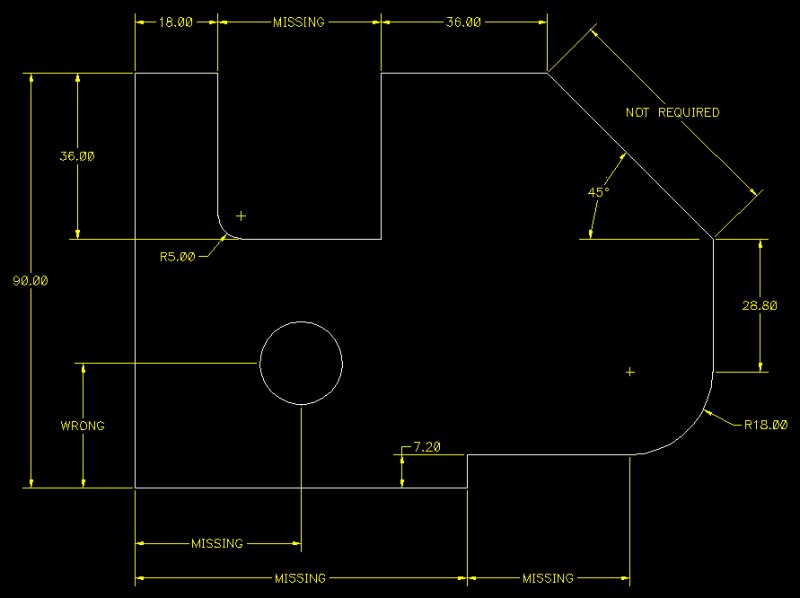

ReMark Posted September 25, 2012 Posted September 25, 2012 (edited) Your instructor needs some help too. What instructor would give an assignment where so much information is missing? Was that intentional? As you see from my drawing it is possible to get fairly close but some assumptions had to be made. And, in my opinion, the 40.00 distance that was given to the center of the circle is wrong judging by the image provided in your first post. I hope you did not pay too much for this class. I think members of this forum could come up with better drawing examples for your class to practice their skills on. Edited September 25, 2012 by ReMark Quote

paisis123 Posted September 25, 2012 Posted September 25, 2012 I agree with ReMark, Its easy to make a recreation of a drawing (Its also my profession), But you need get dimensions right or the entire drawing could be off. Quote
