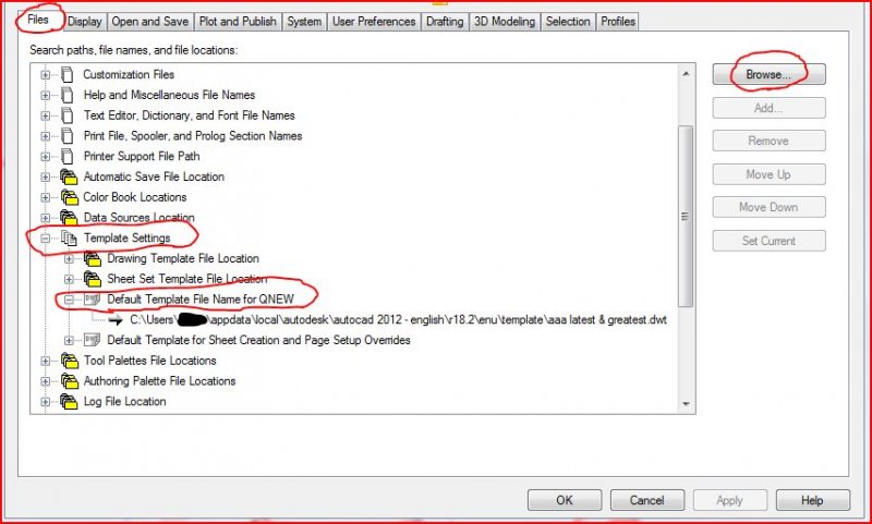

Do you mean the "last" drawing you were working on?
The last drawing or for instance if I use a certain template all the time. Rather than AutoCAD opening the default template, ACAD.DWT. It would open the template that I use? Is that possible?
Create your own DWT and place it in the same folder as all of the other template files. Now, every time you start a new drawing it will grab this template that will have all your layers, linetypes, text styles, dimension styles, etc. already set up and ready to go.
After you have decided on one to use, or better yet, created a .dwt which you would be comfortable using as a starting point you will need to specify it as your default template.
Go into your OPTIONS, as shown in the image .........
as long as you are creating a default template, you might as well make sure you have the drawing units sets as you want them. Use the -DWGUNITS command, and follow the commandline prompts, you might want to hit F2 while doing this so you can see more than 2 lines at a time. :)
Thank yall, I really appreciate the help and that is just what I was looking for. I knew there was a way, but I was looking in the wrong place. I was looking in the Open and Save part and not the File Location. But I got it now.
Thank yall kindly again.

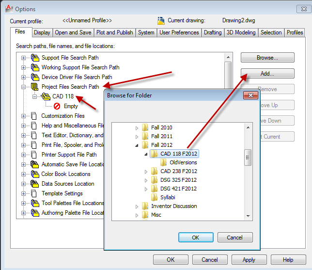

CADLee wrote "Then you always wouldn't have to click so many times to open it and find the folder it was in and so on."
In addition to setting up a search path for YOUR Templates, you might also set up search path for YOUR Projects.
Yes I knew about the RECENT FILES, but that is not what I meant. What I meant is what you answered for me. IN the FILES go to Template settings. That is what I was wanting to do. So all is good now.
