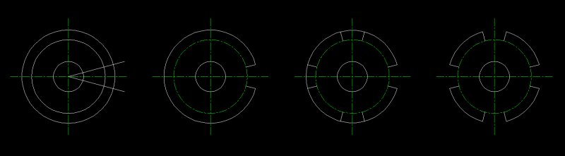

ReMark Posted September 23, 2012 Posted September 23, 2012 Here is one way to approach the problem. OOps...forgot that notch on the outer ring. That's what I get for doing CAD and drinking a beer at the time. Quote

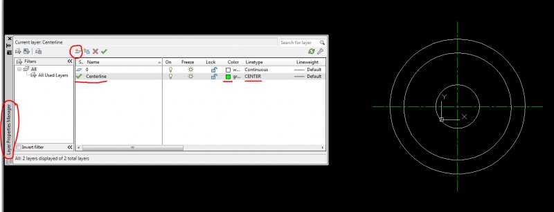

ReMark Posted September 24, 2012 Posted September 24, 2012 (edited) Layers are created in the Layer Properties Manager. You have to click on the icon for creating a New layer. You can accept the layer name that AutoCAD gives you (Layer1 for example) or assign your own like I did (Centerline). You can assign a color to the layer as well as a linetype you would like to use on that layer (like "Center"). My centerlines are on a layer called Centerline, color: green and created with the Center linetype. To get my centerlines to display properly I changed the linetype scale (LTSCALE) to a value of "10" in the Properties palette. I'm pretty sure you have no idea what that is now do you? The lines were put in the drawing using the Line command and I had Orthomode enabled. I drew both lines based upon the quadrant points of the outermost circle. Are you familiar with OSnaps? This feature let's the user make accurate picks of geometry based on ednpoints, midpoints, quadrants, centers, intersections, etc. After I drew both lines I used the Scale command to scale them up 1.25X picking the center of the circles as my base point. Edited September 24, 2012 by ReMark Quote

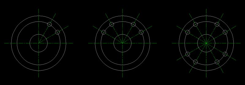

ReMark Posted September 24, 2012 Posted September 24, 2012 Next step is to create the two lines and smaller circles in the right upper quadrant. I used direct distance entry to create each line. Goes something like this. Start the line command, pick the center of the circle (using your OSnaps) as the basepoint, then instead of picking a second point I typed @96>30. That produces a line 96 units long (an arbitrary distance by me) at an angle of 30 degrees. I repeated the procedure for the next line substituting an angle of 60 degrees. Followed this up by drawing a circle at the intersection of the first line and the circle with the 122 diameter. Made my "pick" using the Intersection OSnap. Copied this circle to the second intersection. I used the Mirror command to make a mirror image of the first two circles to the upper left quadrant of the circle then repeated the command to mirror all the small circles in the upper half to the bottom half. Two circles become eight circles in a matter of seconds. I also mirrored the lines that pass through them too. No sense drawing them from scratch right? Quote

ReMark Posted September 24, 2012 Posted September 24, 2012 The notches were constructed using a line at 15 degrees and mirrored. The outer circle was trimmed then I used the Array command (Polar option) to duplicate the geometry at the other quadrants. Trim was used to finish it up. Quote
