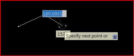

I have a problem with Dynamic Input suddenly displaying dimensions in the middle of a line rather than on screen as I work. What I mean is that if I draw a line the length of the line is displayed at the centre of the line. When I zoom in to one end of this line the display of the length of the line is no longer displayed on screen but remains at the centre of the line. I use AutoCAD 2008.
I have tried various setting but don't seem to be able to fix the problem. Can anyone help?

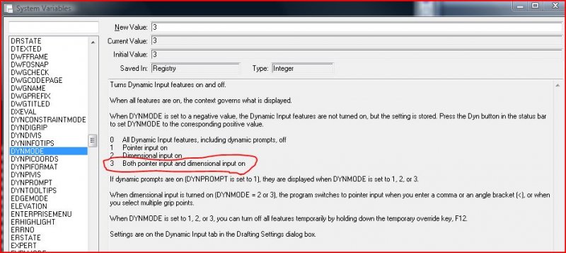

But no, probably not, sounds like your DYNAMIC ENTRY settings got messed up.

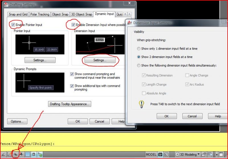

Have you tried these settings?

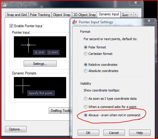

Sorry for all the graphics, try your pointer input setting first. :)

Thanks for your reply. I have checked all the setting and they are OK, and changing them does not cure the problem. I get the length of the line displayed over its center but when I zoom in to one end instead of following me in it remains over the center and to see it I have to zoom out again. Is the file damaged in some way?

Last shot, some more grist for the dynamic input mill.
