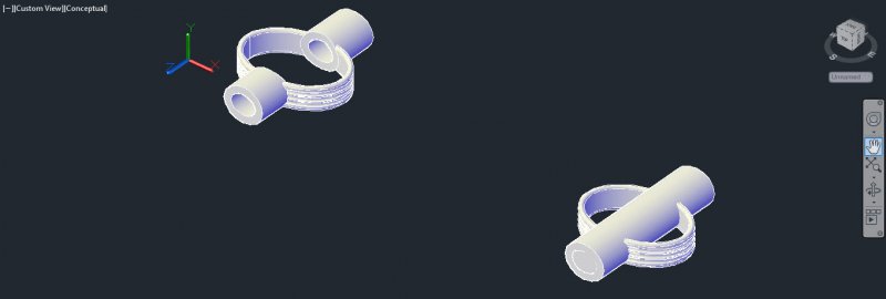

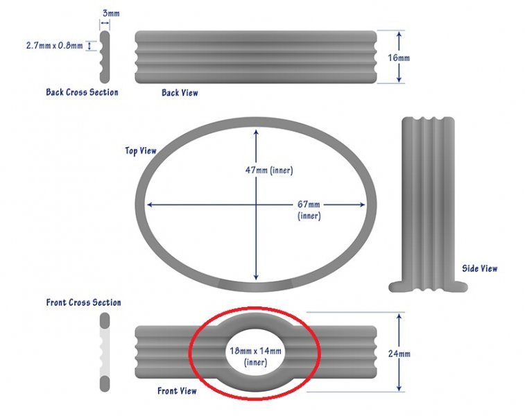

Bobzy20 Posted September 21, 2012 Posted September 21, 2012 I’ve haven’t done any 3D CAD for about 3-4 months now and I can’t seem to remember how to draw this shape I found on the internet. I'm trying to draw the section highlighted by the red circle. Any help would be great. Quote
ReMark Posted September 21, 2012 Posted September 21, 2012 Wouldn't you create a curved "positive" of the fluted shape and subtract it from the oval tube you have above? Quote
ReMark Posted September 21, 2012 Posted September 21, 2012 It looks like you are 90% of the way there judging by the image above. You are trying to derive the ridges (or flutes) in the oval portion of the ring are you not? Quote
Bobzy20 Posted September 21, 2012 Author Posted September 21, 2012 I’m trying to somehow subtract the cylinder from the ridged ellipse shape so I will end up with something that looks like the diagram above. I manage to subtract the cylinder from the inside of the ellipse but that was easy as it doesn’t have a ridged face. I can upload the CAD file if needed. Quote

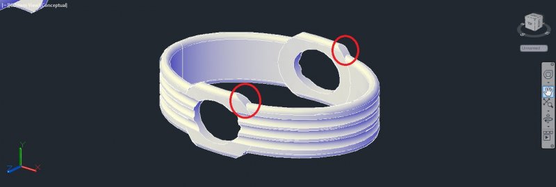

Bobzy20 Posted September 21, 2012 Author Posted September 21, 2012 Looks nice but the red part needs to go up and over at the top and bottom like the image above. Quote

Bobzy20 Posted September 21, 2012 Author Posted September 21, 2012 Looking better we just need to sort out the top and bottom part so it has smooth contours and bends in with the rest of the model where they meets. Quote
ReMark Posted September 21, 2012 Posted September 21, 2012 We? Who's this "we" you mention?:lol: Yes, my "solution" is not exactly elegant by any means. It definitely needs some refinement. Actually, I don't like the way I did it and I keep thinking back to my first suggestion regarding subtracting a "positive" profile of the object. I just haven't figured it out yet. Quote

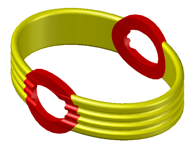

JD Mather Posted September 21, 2012 Posted September 21, 2012 Trim extruded elliptical surface to the "belt-buckle" shape. Thicken. Sweep cut the "ribs". Add fillets. Quote

Dadgad Posted September 21, 2012 Posted September 21, 2012 I am curious how this grew a second of the difficult parts. In the original picture you got from the internet, there is only one of them? Quote
