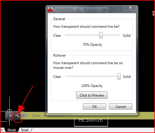

ReMark Posted September 27, 2012 Share Posted September 27, 2012 Above the top of the tabs or sitting directly on top of the tabs? How did you manage that trick? Where were you drawing this 5cm line? In model space or in your paper space layout? After thinking about this long and hard I have come to the realization that you should do everything, geometry, text and dimensions, in model space and forget about using a paper space layout. You are struggling enough already. Draw your geometry FULL size. Do NOT scale the geometry. Forget about text, dimensions, notes and title block/border and just concentrate on the geometry. We'll come back to this later. What do you want to start with? Floor plan, elevations or sections? Quote Link to comment Share on other sites More sharing options...
Dadgad Posted September 27, 2012 Share Posted September 27, 2012 On the left end of the commandline there is a wrench icon, you need to click on that to access all of the settings, which include transparency option. Or alternatively just right click inside your commandline to get those same controls. If you grab the gray tab at the end of the commandline you can put it wherever you want it, including donw in the normal docked psoition. Quote Link to comment Share on other sites More sharing options...
Dana W Posted September 27, 2012 Share Posted September 27, 2012 Look for a button that has a padlock on it down at the lower right corner of your AutoCad window, on the "Status Bar". Click it, and unlock ALL your toolbars. Then you can slide your command line window back where you want it. You may have locked your toolbars after accidentally sliding the undocked command line window over your tabs, just far enough so it did not dock up there above it. I prefer the command line window docked at the very bottom of the screen, and I expand it so it is 3 lines high. It is amazing what you can learn when you can see what commands get executed when you click some buttons or click items on the Draw or Modify menu's. You can dock the command line at the very bottom, like most people do by grabbing it by the little grey grip on one end and jambing it as far as it will slide down to the lower left. It will dock, and expand into the classic AutoCad command line window. then go back and LOCK the toolbars when you have them where you want them. Quote Link to comment Share on other sites More sharing options...

NarkDuffy Posted September 28, 2012 Author Share Posted September 28, 2012 Found the wrench. When I reduced the size of the window as opose to full screen I dragged up the transparant bar and noticed that it continued out to the left (my left) of the screen. I gragged over the main autocad box and in came the familliar command line. I have now moved the command bar to below the drawing screen. This allows me to type directly in to it and read it clearly. Quote Link to comment Share on other sites More sharing options...
