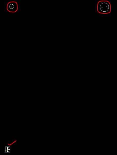

NarkDuffy Posted September 20, 2012 Posted September 20, 2012 Hi I am having issues with creating viewports in the attached file. When I open the layout, say layout 3, it shows the viewport frame but I cannot highlight it in order to delete it. This is a setting in this file I have inadvertently turned on or off. I have created a new file, done a scribble, opened a layout and deleted the viewport. I have googled for a solution before asking the forum and it is most likely very basic. Any help appreciated as I have very little hair left. Nark Plans layer castelnau.dwg Quote

ReMark Posted September 20, 2012 Posted September 20, 2012 Do you know that you have a viewport on a layer named "Y Dimensions"? And you have this layer turned off? Why? You have a layer called Viewports too. Doesn't it make sense to pur your viewports on the Viewports layer? You have a number of lines that are drawn at very slight angles. While they may look straight when zoomed out as you get closer you notice they are not truly horizontal. You also have some ninety degree corners that do not meet up. Why is some of your hatching on the Section Cross Proposed Balcony layer? Seems a bit unusual. Do a Zoom > All. You have some objects that are way, far out from the bulk of your model space objects. Is this intentional? I ran the OVERKILL command on the main group of objects of which there were over 5000. AutoCAD found 168 duplicate lines; it also found 421 instances of lines that overlapped each other. This could cause you some problems down the road and should be addressed now. Quote
ReMark Posted September 20, 2012 Posted September 20, 2012 I drew a white circle around the far out objects in model space and a rectangle around the group of objects that include your house just so I could point them out easier to you. You should erase the objects I circled. Would you look at that. After I erased the objects in the circles I found two more areas where other miscellaneous objects/geometry got thrown off into outer space. You'll have to find and erase them too. Quote
ReMark Posted September 20, 2012 Posted September 20, 2012 Your Section Cross Proposed Balcony Notes seem to be on the Section Cross Proposed Balcony layer. If you don't need the "Notes" layer it can be deleted unless of course you really wanted your notes to be on a layer separate from the geometry they are describing. You have two front elevations of the house. The hatching on the upper portion of each house is on Section Cross Proposed Balcony layer. Since these are elevations and not sections is the hatching on the wrong layer? There are numerous little "orphan" line segments floating about your drawing. These should be cleaned up. Maybe they were left over parts of a previous design that you decided not to use? Oops...looks like that bottom elevation of the house has the hatching on two different layers. One of them is called Section Front and the other is the Section Cross Proposed Balcony layer. None of your elevations should have layers with the word "Section" in them. Quote

NarkDuffy Posted September 20, 2012 Author Posted September 20, 2012 Thanks to everyone. I will save in 2010 in future. For all the other points i may have this or that on or off without knowing it. I will now go through all your notes. Again thrilled at the level of assistance. Thanks Thanks Nark Quote

NarkDuffy Posted September 21, 2012 Author Posted September 21, 2012 Hi Outer space found and destroyed though manually and I am sure that AutoCAD have a more precise manner. Found Zoom Extents. Blip mode First have to find out what it is then turning it off. Couldn't turn off blip mode because I cannot find it. Goggling didn’t help. Lots of entries using code to control it. I do not know how to use code with AutoCAD as yet. Turned on all the layers and have deleted all the viewports. How do I know which layer is controlling my viewport. I have created two viewports. Do I need to create a viewport for each layout I create? Not quite sure what it means to put my viewports in my viewport layer. I will go through this part of the tutorial again. This may be part of the above paragraph. For the section cross and the exterior views I just put everything in the one layer each for simplicity of printing as I don't have the layouts sorted. OK I know this not the correct protocol. Overkill and duplicities. I do not have my mind round how I can have and existing set of drawings and then an overlay layer set for how the property will look when done. There are a lot of walls and parts of walls that will remain. To get round this I created a layer called "Existing to match new in which I only have the existing which will be part of the new. I then add the new work and it all merges so the builders can see what is needed. I have researched overkill and run it. So will be pleased if some of the duplicates are gone but honestly I could see no change. Some of the cockeyed lines may have come when I messed up the integrity of the drawings by hitting the north south control. I thought I had got all lines back to horizontal and vertical. Clearly not but I cannot see the crocked lines. This will not be a major issue as my plans are for the actual building which is running as I am improving the drawings. My drawing to date has allowed the builder to know what I want. It is only a tiny job and will be done in 3 weeks. Is it possible to lock to a layout the layers open for it so that regardless of what I see in Model the layout always sees only what was used to make it? The benefit of this being that I could have my views up to date all the time. Perhaps there will be a macro that I could link top opening a layout which will do all this. I have tried it with the layout Existing in the attached sample but it shows any layer which is made visible. Finally I just cannot get my head round scale. My drawing is 10:1. Which I understand to mean 10 meters on paper = one meter on the ground. Please can you direct me. narkPlans layer castelnau.dwg Quote
