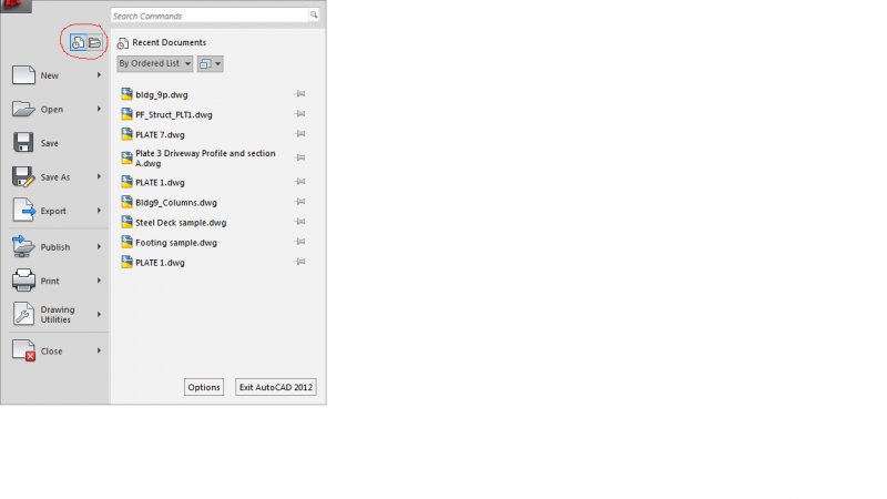

Baiksu Posted September 19, 2012 Share Posted September 19, 2012 Hi I have Autocad lt 2011, on the Application menu listing recent files used, can I remove the ones that I dont use anymore or deleted? Quote Link to comment Share on other sites More sharing options...
ReMark Posted September 19, 2012 Share Posted September 19, 2012 See those two buttons? Toggle between them and notice what happens to the list of files. Not exactly what you may have been looking for but give it a try. "The toggle buttons replace the Recent Documents and Open Documents options that were displayed at the bottom of Menu Browser in AutoCAD 2009." Source: AutoCAD Insider. Quote Link to comment Share on other sites More sharing options...
Baiksu Posted September 19, 2012 Author Share Posted September 19, 2012 I wanna get rid of recent documents list of files that I dont use anymore it still is there. Quote Link to comment Share on other sites More sharing options...

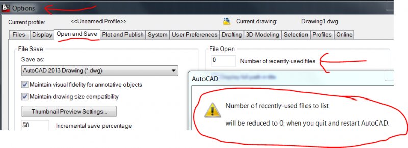

JD Mather Posted September 20, 2012 Share Posted September 20, 2012 Options Quote Link to comment Share on other sites More sharing options...

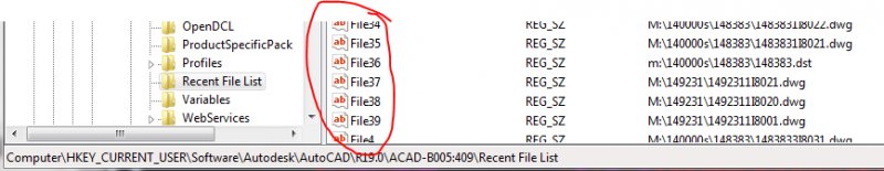

iDeeW Posted November 27, 2013 Share Posted November 27, 2013 Open up registry editor and delete file paths you don't need from Autocad recent file list key..... Just search for Recent File List under "Computer\HKEY_CURRENT_USER\Software\Autodesk\" and delete FileXX keys you don't want to see in Autocad...Restart AutoCAD... In my case the registry path was, Computer\HKEY_CURRENT_USER\Software\Autodesk\R19.0\ACAD-B005:409\Recent File List Quote Link to comment Share on other sites More sharing options...

nestly Posted November 27, 2013 Share Posted November 27, 2013 I agree that diving into the Registry isn't a great solution, however I believe it is the only actual solution. Reducing the number of "recent files" displayed only truncates the list, it doesn't remove unneeded/unwanted files from the list, and it doesn't reset it either. Quote Link to comment Share on other sites More sharing options...

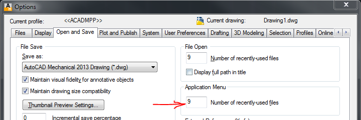

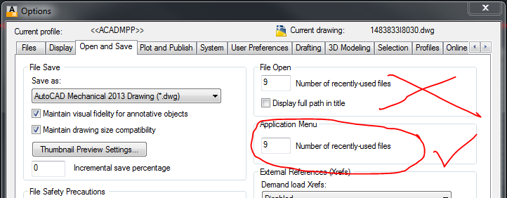

iDeeW Posted November 27, 2013 Share Posted November 27, 2013 Well in that case make sure to put zero on the Application Menu Number of recent file box...See below But then you will not see any files under application menu recent file list at all... Hi I have Autocad lt 2011, on the Application menu listing recent files used, can I remove the ones that I dont use anymore or deleted? So registry hack is the only method I know that will do the trick... Quote Link to comment Share on other sites More sharing options...

Dana W Posted November 27, 2013 Share Posted November 27, 2013 I wanna get rid of recent documents list of files that I dont use anymore it still is there.Follow JD's instructions. Then you have to remember to click the Apply button, and close AutoCad then re-open it to see the changes. Quote Link to comment Share on other sites More sharing options...
nestly Posted November 27, 2013 Share Posted November 27, 2013 Follow JD's instructions. Then you have to remember to click the Apply button, and close AutoCad then re-open it to see the changes. That doesn't change the list (at least for me), it only shortens it. As soon as you increase the number again, all those recent files (whether wanted or not wanted) repopulate. Quote Link to comment Share on other sites More sharing options...
Dana W Posted November 27, 2013 Share Posted November 27, 2013 That doesn't change the list (at least for me), it only shortens it. As soon as you increase the number again, all those recent files (whether wanted or not wanted) repopulate.Yeah, but reducing it and leaving it reduced, to let's say 3 or less, will probably remove those old annoying ones that the OP seems bothered by. I thought that was all they wanted. Quote Link to comment Share on other sites More sharing options...
