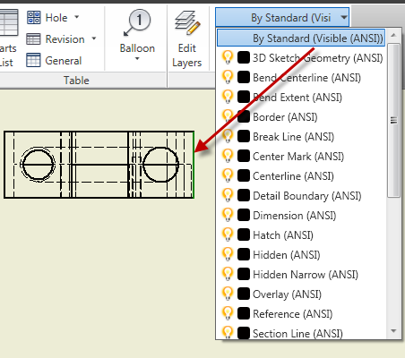

In Inventor go to the Annotation tab and select the line or other entity and you can see from this list what Standard layer it is on.
Layers.pngIn my example I use the ANSI standard (American National Standards Institute).
