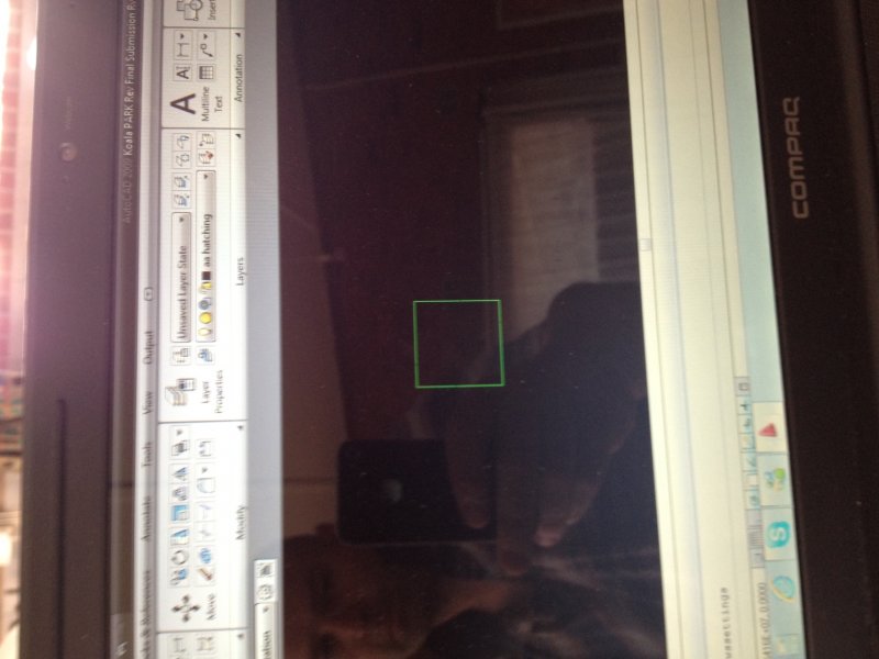

PLS CAN YOU ASSIST ME - I AM RUNNING 2009 AUTOCAD AND HAVE THIS GREEN SQUARE ON MY SCREEN - I HAVE SOMEHOW LOST MY MOUSE /CURSOR AND UNABLE TO GET MY OLD PROPERTIES BACK PLS PLS PLS HELP ... I AM UNABLE TO WORK LIKE THIS ...:unsure:
hi i have this green square acting like a cursor / pointer I cant get rid of for some reason could someone pls pls help
I am desparate to get a drwing done and cant work like this
Thanks

I have restarted autocad several times it still remains the same - green square asif its my cursor?
I started my machine up and it was there I suspect it may be a memory thing but i am not a wizard on CAD - as I move the mouse around the green square simulated my movements , no it only appears in CAD NOT ANY OTHER WINDOWS PROGRAMME

That look like the largest PICKBOX I've ever seen.
Did you try going to OPTIONS and checking your settings?

so ill go into my options ... top tab - selection? change the size ... what about the arrow/cursor all i have is a small green box?

Go to the display tab and make your crosshair size 100 and see if it helps.
Go to drafting tab, make the 'AutoSnap marker size' smaller than what it is currently (I am guessing you have it on the largest size possible).
Dink I am a total plonker .... my cross hairs are black now ... how do i change that ...i got a small pick box (5)

Options => Display => Colours button => change them in there
done thank you ... next question my cross hairs are not at right angles they skew... how do i change them please?
