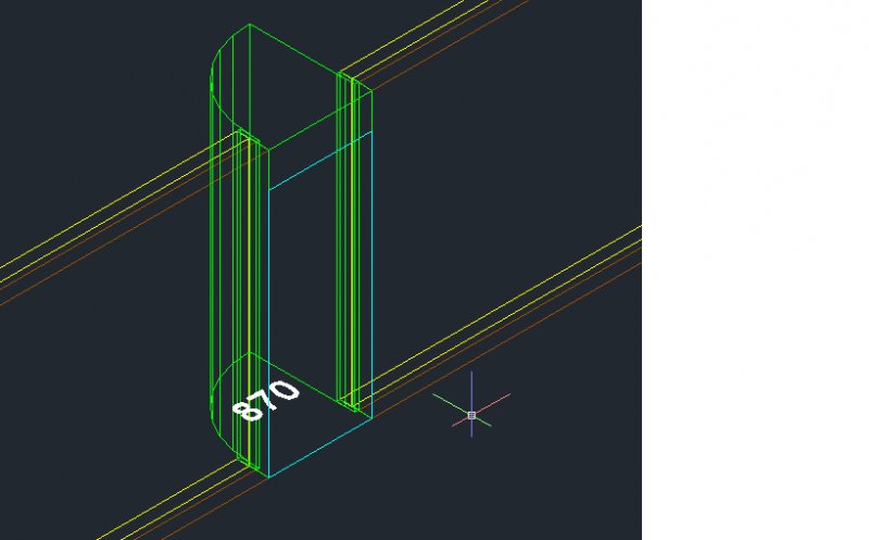

BIGAL Posted September 16, 2012 Posted September 16, 2012 Is this what your trying to do, plus lots more if so private email me the add on to do simple house designs is still avaialble can supply details Quote

BIGAL Posted September 23, 2012 Posted September 23, 2012 All you have to do is use the polar command to work out the intersecting points on the other wall skins then use break and draw lines etc Always pick either inside or outside line then you know which way wall is located. The example I posted is created via all plain old fashioned lisp. But I would go down the VL way now removes lots of coding. pi3 is 270 deg door line pts b d wall w2 w3 w4 double skin wall (setq pt3 (polar b (+ pi3 (angle b d)) (+ w2 w3 w4))) Quote

BIGAL Posted October 15, 2012 Posted October 15, 2012 Must have had a brain drian when I posted above Further to PBe code you only need pick line once pick left side of door enter distance from end therefore know right side of door on line via polar then can do break. The pick point for direction is not needed as you pick door on left side of wall implying which way is say in. You get used to left and right very quick even when upside down. I would post the code but its copyrited. Quote
