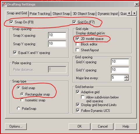

netman Posted September 15, 2012 Share Posted September 15, 2012 I can not get the cursor to snap to the grid in any size of grid. Object snap works just fine. I know I did something wrong, but what? Any help is appreciated. AC 12 Lt Quote Link to comment Share on other sites More sharing options...
rkent Posted September 15, 2012 Share Posted September 15, 2012 2012 snap works in a command only, unless you have the sp installed. I think they. Added a snaplegacy or classic snap sysvars. With autocomplete on type *snap* to find it, I am not at a computer with AutoCAD. Quote Link to comment Share on other sites More sharing options...
Dadgad Posted September 15, 2012 Share Posted September 15, 2012 Check your Snap & Grid settings against the image. Quote Link to comment Share on other sites More sharing options...
Dadgad Posted September 15, 2012 Share Posted September 15, 2012 Good call there rkent. Strangely it doesn't even register in SYSVDLG, but per your suggestion the autocomple provides us with the name ... SNAPGRIDLEGACY. Still not listed in SYSVDLG, but appears the default is 0, so you should need to set it to 1. Can't imagine how you might have accidentally changed that one though? Quote Link to comment Share on other sites More sharing options...

netman Posted September 17, 2012 Author Share Posted September 17, 2012 Thank you gentlemen for the information. All is well again in the bayou country. Taking a suggestion from here I made a template of all the things i use. Somehow I turned off the snap grid. As for why i use it , it helps me put things into scale. I can not do scale well enough or even know how to get it right. I use the Snap to grid feature to cheat. Case in point; I am working on a gear that mounts on eitehr side of a boat. the trailing ends of the two nets have to come past the the propellor while being towed in a straight line, But must just miss the prop when the boat turns sharply. NOT being skilled as you all are....I cheat and use the grid system to determine real world angles. * sort of like counting on one's fingers because one can not use a calculator... ha ha !! Thank you all again. The screen shots work perfect for my skill level...Show-N-Tell....... Quote Link to comment Share on other sites More sharing options...
