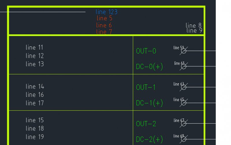

chris2x1 Posted September 18, 2012 Author Posted September 18, 2012 test.dwg I have loaded the lisp successful but i get this message Attupbyrow.lsp successfully loaded. Command: ; error: bad argument type: lselsetp nil plus i dont know what the comman is to launch the lisp. I have added the block above you will see 3 empty boxes at top and basically i want to move the text from the boxes below the 3 empty ones into those three Quote

BIGAL Posted September 20, 2012 Posted September 20, 2012 (edited) Had a couple of minutes your block is all over the place in the way its created have a look at image, the only way this would work is pick block and window attributes to weed out those you dont want and then like before sort them into some form of order and update, maybe a window attributes then window where to place them. I am sure it can be done. You need to find a pick attribute off screen I am pretty sure there is code here to do that. Then you can cut and apply. You would need say a "." to see update line. There is a current post find point inside another object you could use something like this to check that attibute is within window area. Like before it could be done but not an easy task. http://www.cadtutor.net/forum/showthread.php?72815-Point-inside-or-outside-of-another-entity Edited September 21, 2012 by BIGAL Quote
