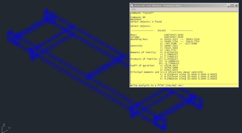

Dadgad Posted September 13, 2012 Posted September 13, 2012 Welcome to the forum. MASSPROP is an awesome command, it will only work on solids or regions. I exploded the xrefed image here, then used union so that MASSPROP would treat it as an assembly. This was done in Autocad Vanilla, I am not sure, but would think that REVIT must have it, or something like it. As you see at the bottom of the window, there is an option to write the information to a file too. Quote
