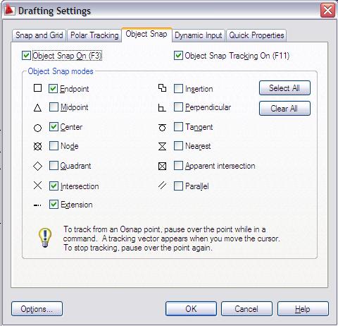

cuba_pete Posted September 12, 2012 Author Posted September 12, 2012 What osnap settings do you have active? I have never really changed any of the default properties for AutoCAD, so *osnap* is new to me. I think it's easier if I just post the image: Quote
JD Mather Posted September 12, 2012 Posted September 12, 2012 All looks well there. (except I would turn on Modpoint and maybe Tangent) Post the dwg (just need a rectangle, line and circle). Quote

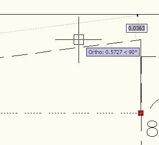

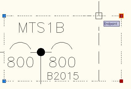

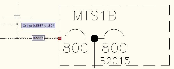

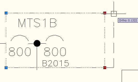

cuba_pete Posted September 12, 2012 Author Posted September 12, 2012 It was already set to 0 (zero), but I reset it anyway. No change. The screen shots I include here may show clues. When I try to simply stretch a line it only gives two options: up and down, and back with that Ortho label. That used to say Specify Stretch Point, not Ortho. Now again, when I try to stretch back to the mid-point, the snap selectpoint (orange box) is show at the lines source and snaps to there. This is one of the really weird parts. When I try to change the size of a box (polyline rectangle, whatever) I can only move in the direction of the particular side I have selected. In the graphic here, see how the top right grip is selected as the snap point even though my crosshairs are to the left? It will not let me specify anything to the left as a stretch point. This works similar depending on selecting top, bottom or sides. I can only *increase* the size of the box. Short of submitting a request to my IT department I am at a loss. That will take weeks. There has to be a logical explanation for this. I must have changed some setting inadvertently but I cannot figure it out. Quote
cuba_pete Posted September 12, 2012 Author Posted September 12, 2012 Got it...solution found. I Googled Ortho and came up with the hint I needed. I never saw that Ortho box before...it always said Polar. When I entered the command Ortho and set it to off everything returned to *normal*. There must be a hot-key for that as well and I somehow invoked Ortho mode. I can see the benefits to that mode, but it doesn't work for me right now. Quote
