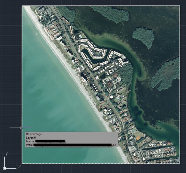

** Update -
I thought I'd get back into this old thread a bit... As it happens, I was mistaken about the requirement for incorporating the MouseHover Event handler (a real shock to anyone who knows me :P).
While I've not finished coding the entire plug-in that does everything that the OP has requested here (to toggle the image on/off by hover), the draft version (attached) adaptation uses the Editor.PointMonitor Event handler to detect what entity is being hovered upon (in this case it looks for when you hover the frame of an raster image), and subsequently displays a ToolTip reporting the image, the Layer on which it resides, the image Name, and Path Properties.
As this is just a draft, I am not going to waste others' time by posting the source-code... If you'd like to take a crack at coding this yourself, feel free, as my draft offering is an adaptation of Kean's and Tony's code here:
Providing information on AutoCAD objects in a tooltip using .NET
To test the plug-in attached to this post, download the AcImageHover18.txt file, right click, unblock, remove the .TXT file extension leaving the file as a .DLL, then NETLOAD the resultant assembly, and use the newly added IMAGEHOVERON, or IMAGEHOVEROFF Commands to test.
** Note - This assembly was compiled using .NET 3.5, and tested successfully using Civil 3D 2011, 2012.

Screenshot attached
I've update my previous post to include an assembly build which also displays some RasterImage-specific Property information, rather than simply the Layer property value in the ToolTip.
