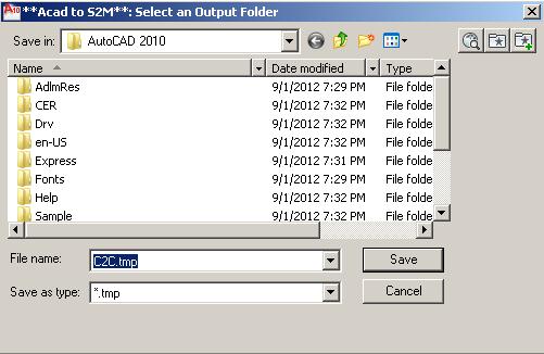

I have the "getfiled" function installed in one of my Lisps. When the user needs to store a file location, it should always be in the same folder: H:\Job Specs. However, getfiled always defaults to: C:\Program Files\AutoCAD 2010 from which the user then has to navigate to the H drive.
Does anyone know if there is a method and/or registry location where I can set the H drive location as a default?

I'm answering my own question because I found it pretty quick after posting and thought it would be helpful to someone else..
If you want the directory to default to the current directory of the current drawing use (getvar "dwgprefix").
Example: (setq fn (getfiled "Text Export File" (getvar "dwgprefix") "txt" 1))

Taking this old thread a little further,  how can I use the (getvar 'dwgprefix) and set the save drawing name together?
(setq PreFileName (getfiled "Input name of PRE drawing to save" ( strcat File_PreName FileName) "dwg" 1))
how to add (getvar 'dwgprefix) so that the current drawing path is selected?
if I try to combine them I of course get a to many arguments error.

@Least All you have to do is include the (getvar "dwgprefix") within the (strcat ..) part:
(getfiled "Input name of PRE drawing to save" (strcat File_PreName FileName) "dwg" 1)
to
(getfiled "Input name of PRE drawing to save" (strcat (getvar "dwgprefix") File_PreName FileName) "dwg" 1)

Just the job. works just how I want it.  Thanks
