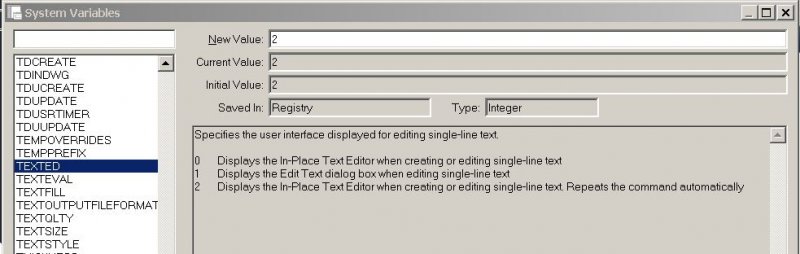

Just so you are aware of the other optional settings for this,
here is a shot of the SYSVDLG (system variable dialog) explaining
the available settings. This is always a great place to start
when a command's behavior seems to have gone astray.
Whoops, not sure if you have SYSVDLG in 2011, it is in 2012 and up.

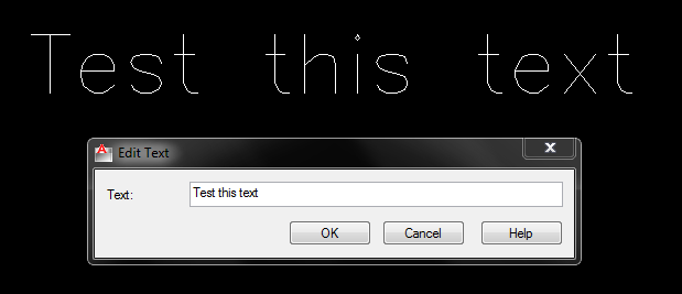

This is the result one gets if you follow rkent's advice re: setting TEXTED to a value of "1". The test text pictured was created as single line using the TEXT command.
