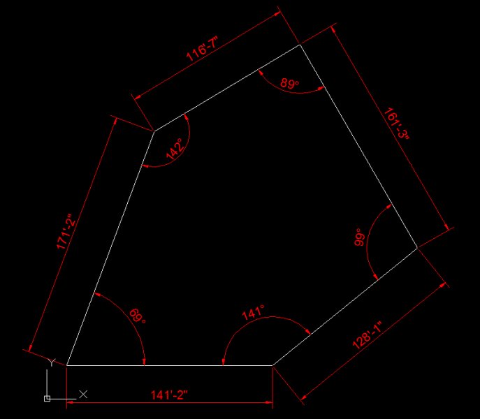

ReMark Posted September 17, 2012 Posted September 17, 2012 Exercise 1.3 Site Boundary As you see I provided the missing distance and angle. I don't do this type of drawing much any more and my "old school" method (which still evidently works) might not be the best one to use. And, since I'm not much of a Polar Tracking or Object Snap Tracking kind of user I would be hesitant to explain the use of either command. So, this is where I call upon another forum member to graciously step in and explain the nuances of drawing a line at an angle relative to another line in such a manner that frederico can fully understand it. Be advised that his English language skills may be somewhat limited. One other option might be to copy and place the original line in place then use the Grip Edit method. I first read of this technique as demonstrated by forum member nestly at the AutoDesk Discussion Groups. Quote

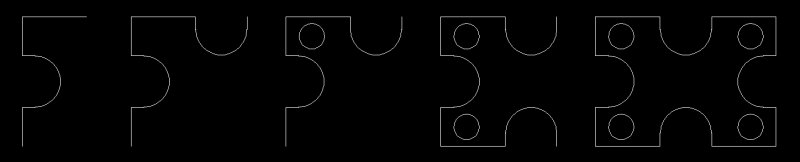

ReMark Posted September 17, 2012 Posted September 17, 2012 Exercise 2.8 Gasket Fairly simple. Mostly made use of the MIRROR command to save redrawing duplicate geometry. Since no dimensions we given in the diagram I assumed each square of the grid (in the diagram) to be equal to 1 unit. I turned off the grid in my drawing when I made this image so the geometry could be seen better. Quote

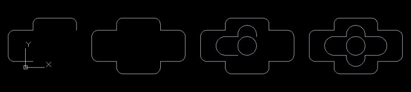

ReMark Posted September 17, 2012 Posted September 17, 2012 Exercise 2.9 Shape Ah what the heck. Here's another one. Make the MIRROR command your friend and this one will be a piece of cake. Once again I assumed that each square of the grid in the book's diagram was equal to 1 unit. Quote

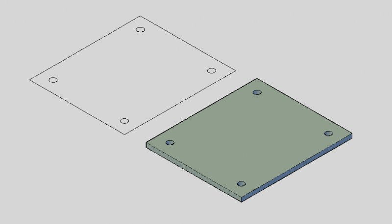

mitey-quin Posted January 21, 2013 Posted January 21, 2013 I have this book 2013 autocad 3D secondl level, by shih, I can follow along but when I get to the lesson I can't make the jump to apply to the lesson I did a floor plan in the tutorial now they want me to draw a baseplate I am doing the 1. baseplate I can draw it flat fine, when I use the thickness .5 in properties, I only get a line up in Z direction, How do make it a solid and the circles fill in too, I made the boss part but it is solid too, I must be leaving something out, but what. Quote
ReMark Posted January 21, 2013 Posted January 21, 2013 (edited) Do not use the THICKNESS command. Draw your baseplate in 2D using lines or polylines then use the PRESSPULL command to give it height. Precision is gained by typing in the desired height at the command line. Might I suggest that in the future you start a new thread rather than tack your question onto a previous thread. It will be seen by more people and generate more responses. Edited January 21, 2013 by ReMark Quote
ReMark Posted January 21, 2013 Posted January 21, 2013 An example of a baseplate modeled as a 3D solid using the PressPull command. The plate is 12x14, it is 0.5" thick and the four holes are 0.75" in diameter. This took less than 30 seconds to do. The visual style is Conceptual while the view is SE Isometric. Any questions? Quote
