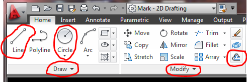

ReMark Posted September 10, 2012 Posted September 10, 2012 The "Ribbon" is found at the top of your screen. It has several tabs with different panels on each tab. This version is for 2D Drafting. There is a different one for 3D Modelling. Above the Ribbon I have elected to show the Menu Bar which has drop-down menus under each heading. In the upper left hand corner is the Quick Access Toolbar (QAT). All these elements can be customized by the user to suit his or her own needs and work style. Quote

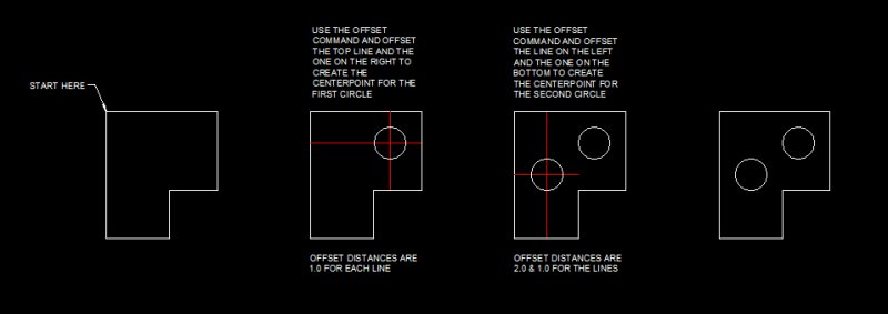

ReMark Posted September 10, 2012 Posted September 10, 2012 (edited) Exercise 1.4 done using the LINE, CIRCLE and OFFSET commands found on the Ribbon. The basic shape of the filter plate can be constructed in the same manner as the objects in the first two exercises (drag a line and type a distance). This is where you find the commands. Why OFFSET? Despite the fact there are probably two or three other, probably faster ways of doing this, I think you are lacking in your knowledge of even the most basic commands let alone more advanced techniques. Maybe someone will be kind enough to create a video for you demonstrating another way of accomplishing the task using Polar Tracking and Object Snap Tracking. See post #32 for an explanation of the OFFSET command. It includes an image as well as a sample drawing file to use to practice the technique I have described. Edited September 11, 2012 by ReMark Quote

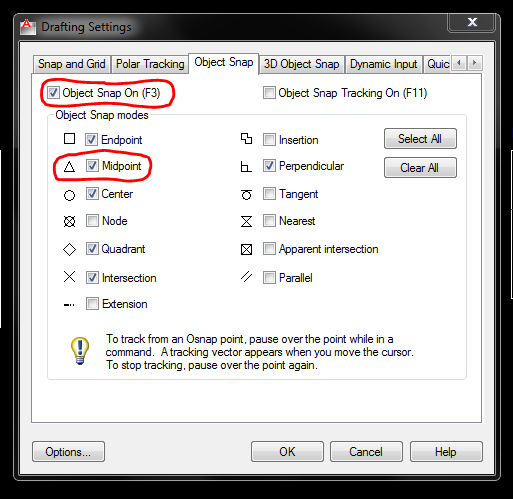

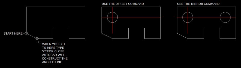

ReMark Posted September 10, 2012 Posted September 10, 2012 Exercise 1.5 can be done similar to 1.4 in terms of the linework and one of the two circles. For the second circle (on the right) I would use the MIRROR command and pick the Midpoint of the top line. This means however you will either have to key in the letters MID when asked for a base point in the MIRROR command or pick it if you have your OSNAPS set up with Midpoint enabled. Common OSnaps most users enable are Endpoint, Midpoint, Center, Quadrant, Intersection, Perpendicular, and Parallel. So for this exercise use the LINE, OFFSET, CIRCLE and MIRROR commands and you should do just fine. Quote
ReMark Posted September 10, 2012 Posted September 10, 2012 What the OSnaps "Settings" dialog box looks like. You can activate it by right-clicking on the Object Snap button in your Task Bar or by typing OSNAP at the command line then pressing ENTER. Quote

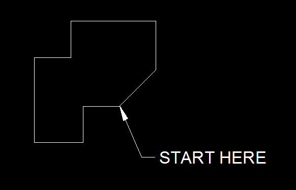

ReMark Posted September 10, 2012 Posted September 10, 2012 Exercise 1.6 is an easy one. Drag the line enter the distance and use the "Close" option to finish it off where the diagonal line is. Shouldn't take you more than 30 seconds. All you need is ORTHO mode turned on and the LINE command. Start where indicated and proceed in a clockwise direction. Skip Exercise 1.9 and go directly to 1.11; we'll come back to 1.9 later. Quote

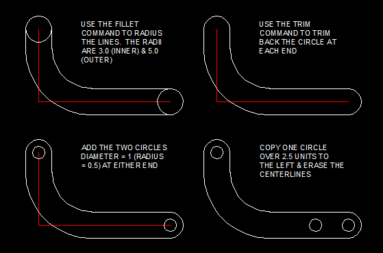

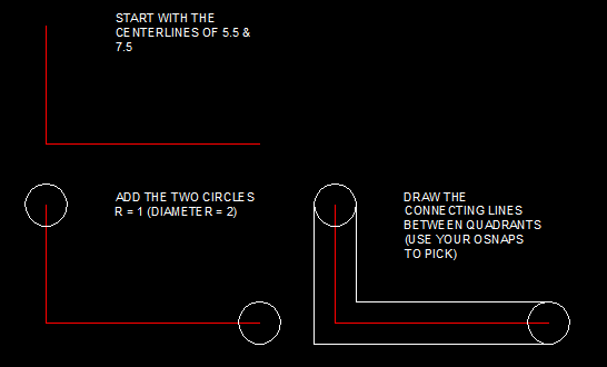

ReMark Posted September 10, 2012 Posted September 10, 2012 Exercise 1.11 is going to require that you enable and make use of the Quadrant OSnap. You can actually calculate the length of lines needed on each side to connect the two end circles saving you the time to Trim or Fillet (with a radius of "0"). I believe the diagram gives the wrong radii for the inner/outer large curves (or "fillets"). Use the FILLET command to create them. You'll need to use the COPY command. Just make sure ORTHO mode remains toggled as you copy the circle 2.5 units to the left which can be entered at the command line. Quote

fredericofrg Posted September 11, 2012 Author Posted September 11, 2012 Thanks ReMark for your help. (you were either taught very little, or you did not pay much attention in class.) Just i think don't understand the class because i just learn basic english for 5 months before move to US. Can i ask you one thing? If yes in the start to the exercise 1.1 Baseplate i need use the command LINE and i need put the first line size? example 2.50 or i need specify one point to the line start and after this where i can put the first and second line size? Thanks so much, i just start right now,again ^^ but now i know more things. Quote
Dadgad Posted September 11, 2012 Posted September 11, 2012 (edited) ReMark has given you the commandline input. He tells you EXACTLY what to do in POST #14. Read the entire post, make the hand sketch before you start drawing the lines with the program. MAKE SURE YOUR ORTHO IS TURNED ON before you start, just like ReMark says. After starting the LINE command and indicating a starting point for it, you will indicate the direction in which you would like the line to go by moving your mouse in that direction, then you will enter the number (length of the line), and hit ENTER (not TAB). Your first line is now drawn, FOLLOW THE COMMANDLINE PROMPTS, for the next line you do not need to restart the LINE command because it is still running. Just move your mouse in the direction which you want the next line to go, enter the length of the next line, and hit ENTER again. It is hitting the ENTER button which tells the program to go ahead and create the line which you have just defined. You will do it after every distance (length) entry, before indicating the information for the next line. To complete the last line in the drawing (of a closed shape) you may use the CLOSE option, for which you just enter C at the commandline, then ENTER. Edited September 11, 2012 by Dadgad Quote

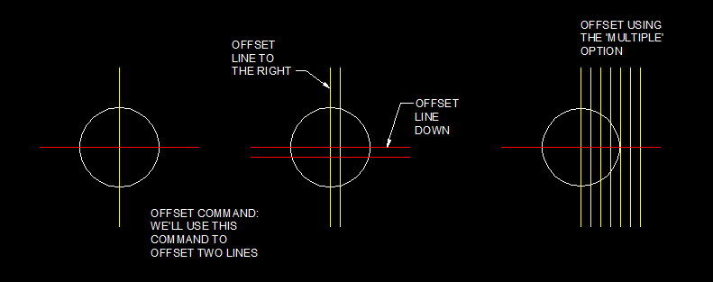

ReMark Posted September 11, 2012 Posted September 11, 2012 Using the OFFSET command. Start the OFFSET command. Look at your command line. AutoCAD responds: Specify offset distance or [Through/Erase/Layer] : The number you see between the is the last offset distance used. I want you to change this to .25 so that is what you will type then press the ENTER key. AutoCAD responds: Specify offset distance or [Through/Erase/Layer] : .25 (AutoCAD has accepted your input) Select object to offset or [Exit/Undo] : (AutoCAD is expecting you to pick an object to offset) Pick anywhere on the yellow line, then move your cursor to the right and click your left mouse button. A second yellow line should appear. AutoCAD continues to ask you to select object to offset so pick the red line, move your cursor down and click your left mouse button. A second red line should appear. Right click and from the fly out menu select "Cancel". The OFFSET command has been cancelled. Start the OFFSET command again. Use the default distance of 0.25 previously specified (just hit the ENTER key to accept). AutoCAD responds: Select object to offset or [Exit/Undo] : Pick the yellow line then STOP! Look at your command line. AutoCAD has now responded: Specify point on side to offset or [Exit/Multiple/Undo] : Type the letter "M" for "Multiple" then press the ENTER key. AutoCAD responds: Specify point on side to offset or [Exit/Undo] : Move your cursor and pick to the right of the yellow line. Keep moving your cursor to the right and picking five more times. When you are finished press the ESC keep (upper left-hand corner of your keyboard). Think you understand how the OFFSET command works? I have attached a DWG file for your use that includes the circle and two lines. Offset sample.dwg Quote
