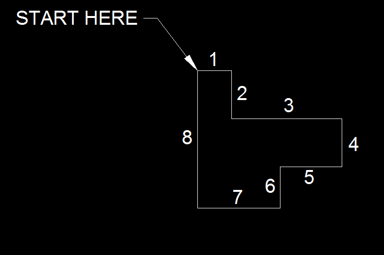

ReMark Posted September 10, 2012 Posted September 10, 2012 Exercise 1.1 Baseplate. Make sure you have ORTHOMODE enabled. Use your F8 key to toggle it. Prior to starting this exercise make a quick hand sketch of the baseplate and put the dimensions on it. You'll notice that you will have to calculate a couple of the dimensions based upon those that are already given. When you have all the dimensions of every side then you can draw the baseplate in AutoCAD. Note: We will be working our way around the baseplate in a clockwise manner. Start the LINE command. Pick anywhere in the middle of your screen when you are prompted "LINE Specify first point:" as this object, if I read the dimensions right, is not very big. Now drag your mouse to the right. Look at your command line. AutoCAD prompts "Specify next point or [undo]:". I want you to type in the distance 2.0 then press ENTER. AutoCAD should draw the line. As AutoCAD continues to prompt you for the next point drag your mouse downward and type the distance 2.0 at the command line. Once again a line should be drawn on your screen. Now drag your mouse to the right and type 2.0 one more time. You should have three lines on your screen. You can continue with this same procedure (drag and type in the distance) until you work your way around to the next to the last line. When prompted for the last line sement you can just type the letter "C" for "Close" and AutoCAD will complete the baseplate. Quote
ReMark Posted September 10, 2012 Posted September 10, 2012 The order in which the lines should be drawn using the method I described previously. AutoCAD continues to prompt the user to "specify the next point" until the command is cancelled or the last response is "Close". Here is the sequence that is followed as taken from the AutoCAD Text window: Command: Command: LINE Specify first point: Specify next point or [undo]: 2.0 line 1 Specify next point or [undo]: 2.0 line 2 Specify next point or [Close/Undo]: 2.0 line 3 Specify next point or [Close/Undo]: 2.5 line 4 Specify next point or [Close/Undo]: 3.0 line 5 Specify next point or [Close/Undo]: .5 line 6 Specify next point or [Close/Undo]: 2.5 line 7 Specify next point or [Close/Undo]: 2.5 line 8 Specify next point or [Close/Undo]: 1.5 line 9 Specify next point or [Close/Undo]: c line 10 drawn by AutoCAD automatically Quote
ReMark Posted September 10, 2012 Posted September 10, 2012 I have determined that Exercise 1.2 can be done in the same manner as 1.1 was. When you get to the end of line number 7 just type "C" for "Close" and AutoCAD will draw line number 8 for you. See below. Command: Command: LINE Specify first point: Specify next point or [undo]: .5 line 1 Specify next point or [undo]: .7 line 2 Specify next point or [Close/Undo]: 1.6 line 3 Specify next point or [Close/Undo]: .7 line 4 Specify next point or [Close/Undo]: .9 line 5 Specify next point or [Close/Undo]: .6 line 6 Specify next point or [Close/Undo]: 1.2 line 7 Specify next point or [Close/Undo]: C "C" for Close You should now have two exercises done. Quote

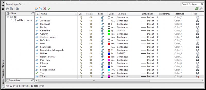

ReMark Posted September 10, 2012 Posted September 10, 2012 The Layer Properties Manager. This is where you create all your layers and define their properties. The default AutoCAD template, acad.dwt, opens when you start a new drawing. There is only one defined layer (Layer "0" - color: white) in this template. You can create a custom template file with all your layers predefined. It is a real time saver. Quote
