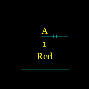

In the response to my email, the OP has noted that they wish to have a drop-down for multiple attributes in the block, and so I have offered this further suggestion, copied here for the benefit of the community:
Since you wish to modify multiple attributes in your block via a drop-down list, an alternative method to consider would be to use Field Expressions within the attribute values, linked to multiple Lookup Parameters in the Dynamic Block.
This way, the user could modify the value of the attribute using the relevant Lookup Parameter drop-down list and the value would be updated by the Field Expression referencing the Lookup Parameter. The only drawback of using this method is that a Regen would be required to update the Field housed in the attribute.
I have attached an animated gif to demonstrate this behaviour and have also copied my responses to your emails to your thread at the CADTutor forum to benefit the CAD community there.
