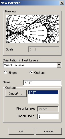

meridian Posted September 7, 2012 Author Share Posted September 7, 2012 dynamic block? there are no blocks in revit all i did was change the .txt file to a .pat file, that works and im actually able to load it in revit but in my preview screen and on plan it shows the lines out of whack Quote Link to comment Share on other sites More sharing options...
ReMark Posted September 7, 2012 Share Posted September 7, 2012 Out of whack how? Did you adjust the scale factor as suggested in the last post of the thread you got the hatch from? Can you post an image? Quote Link to comment Share on other sites More sharing options...
meridian Posted September 7, 2012 Author Share Posted September 7, 2012 this is what i see, changing the scale makes it worse Quote Link to comment Share on other sites More sharing options...

Lee Roy Posted September 10, 2012 Share Posted September 10, 2012 Revit has an insulation button (Annotate Tab -> Insulation). Try as you will, you will NOT get a batt insulation pattern to work as you want it to. Trust me, I've spent countless hours trying and there's not much in Revit that I cannot do. Quote Link to comment Share on other sites More sharing options...
