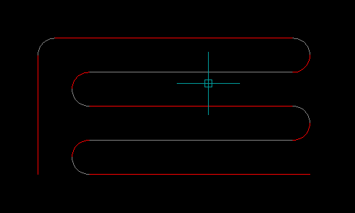

Join line/s and polyline/s which meet on their ends by selecting just one of them
ctdlc888
hello great lispers. I wondered of a shorter way to apply in my problem which is to join line/s and polyline/s which meet on their ends by one selection of any of them then voila they are joined, then the command line is in the offset prompt.In the sample drawing (not mine) the lines-polylines are in yellow color which I want to join and offset as in blue situation.Thank you

How are we expecting the polyline/line that is selected to know there is another line/polyline at the selected end to be joined up with? Are we assuming the lisp routine will recognize a shared coordinate?
Yes Remark, a shared coordinate. and i think of a new one, by extended intersection in case they do not meet at ends, whichever .
Dadgad thought you were joking yes there is a command OVERKILL.
Re magicly joining lines whats wrong with just PE J and a window it automatically finds all the touching lines.
Connect the not touching you could do a Pe J window and then use the new pline to work out the intersecting points, then ammend the pline adding/subtracting segments. Pity HPGAPTOL does not work on make plines or does it anyone ?
It is a great command, I always use it after SOLPROF to clear out any deadwood and duplicated lines. :)

Not familiar with that, I will read on OVERKILL Dadgad. Also with your 'Pe J and window' BIGAL, i'm curious-what's that. To study Lisp would be hard for me at 54 but i think of how lisp and you guys help.
Use the following simple code to join the yellow segments in your drawing to form a single continuous LWPolyline:
(defun c:pj ( / c p s )
   (if (setq s (ssget "_:L" '((0 . "LINE,ARC,LWPOLYLINE"))))
           (setq p (getvar 'peditaccept)
                 c (getvar 'cmdecho)
           (setvar 'peditaccept 1)
           (setvar 'cmdecho 0)
           (command "_.pedit" "_M" s "" "_J" "" "")
           (setvar 'cmdecho c)
           (setvar 'peditaccept p)
Then perhaps use EXOFFSET to perform the multiple offsets.
Thanks Lee Mac.It prompts to select objects. Can it be done to select any one line/polyline to select all, as in the title of the thread?
Just isolate the layer of the yellow segments (LAYISO), window over the objects, then unisolate the layers (LAYUNISO / LAYON).
I have just unified the yellow to one layer and color. Previously when i got it was mixed up with layers(unorganized) from several polygons.I'm interested in post #2 of ReMark.Sorry for much disturbing you

hello. But it is cumbersome to select each yellow touching lines & polylines. I just want to select one and everything sharing a common coordinate(endpoint) is selected.
I like your idea, along the lines of the Express Tool FASTSEL, only it would grab everything in a string.
However if you start the pedit command, select one yellow section, select Join, then window everything or type all, only items in a string with the first yellow line will be joined.
This method could even be automated in a similar way to my previous suggestion:
   (if (setq s (ssget "_+.:E:S:L" '((0 . "LINE,ARC,LWPOLYLINE"))))
                 c (getvar 'cmdecho)
           (setvar 'cmdecho 0)
           (command "_.pedit" (ssname s 0) "_J" "_All" "" "")
           (setvar 'cmdecho c)
           (sssetfirst nil (ssadd (entlast)))
Try the command PL-CSE from one of my project

Here is my version of a 'Chain Selection':
[color=GREEN];;--------------------=={ Chain Selection }==-----------------;;[/color]
[color=GREEN];;                                                            ;;[/color]
[color=GREEN];;  Prompts the user to select an object and generates a      ;;[/color]
[color=GREEN];;  selection chain of all objects sharing endpoints with     ;;[/color]
[color=GREEN];;  objects in the accumulative selection.                    ;;[/color]
[color=GREEN];;------------------------------------------------------------;;[/color]
[color=GREEN];;  Author: Lee Mac, Copyright © 2012 - www.lee-mac.com       ;;[/color]
([color=BLUE]defun[/color] c:cs ( [color=BLUE]/[/color] en fl in l1 l2 s1 s2 sf vl )
   ([color=BLUE]setq[/color] sf
       ([color=BLUE]list[/color]
          '(-4 . [color=MAROON]"<OR"[/color])
              '(0 . [color=MAROON]"LINE,ARC"[/color])
              '(-4 . [color=MAROON]"<AND"[/color])
                  '(0 . [color=MAROON]"LWPOLYLINE,SPLINE"[/color])
                  '(-4 . [color=MAROON]"<NOT"[/color])
                      '(-4 . [color=MAROON]"&="[/color])
                      '(70 . 1)
                  '(-4 . [color=MAROON]"NOT>"[/color])
              '(-4 . [color=MAROON]"AND>"[/color])
                  '(0 . [color=MAROON]"POLYLINE"[/color])
                      '(-4 . [color=MAROON]"&"[/color])
                      '(70 . 89)
                  '(0 . [color=MAROON]"ELLIPSE"[/color])
                      '(-4 . [color=MAROON]"<>"[/color])
                      '(41 . 0.0)
                       ([color=BLUE]cons[/color] 42 ([color=BLUE]+[/color] [color=BLUE]pi[/color] [color=BLUE]pi[/color]))
                  '(-4 . [color=MAROON]"OR>"[/color])
           ([color=BLUE]if[/color] ([color=BLUE]=[/color] 1 ([color=BLUE]getvar[/color] 'cvport))
               ([color=BLUE]cons[/color] 410 ([color=BLUE]getvar[/color] 'ctab))
              '(410 . [color=MAROON]"Model"[/color])
   ([color=BLUE]if[/color] ([color=BLUE]setq[/color] s1 ([color=BLUE]ssget[/color] [color=MAROON]"_X"[/color] sf))
       ([color=BLUE]if[/color] ([color=BLUE]setq[/color] en ([color=BLUE]ssget[/color] [color=MAROON]"_+.:E:S"[/color] sf))
           ([color=BLUE]progn[/color]
               ([color=BLUE]setq[/color] s2 ([color=BLUE]ssadd[/color])
                     en ([color=BLUE]ssname[/color] en 0)
                     l1 ([color=BLUE]list[/color] ([color=BLUE]vlax-curve-getstartpoint[/color] en) ([color=BLUE]vlax-curve-getendpoint[/color] en))
               ([color=BLUE]repeat[/color] ([color=BLUE]setq[/color] in ([color=BLUE]sslength[/color] s1))
                   ([color=BLUE]setq[/color] en ([color=BLUE]ssname[/color] s1 ([color=BLUE]setq[/color] in ([color=BLUE]1-[/color] in)))
                         vl ([color=BLUE]cons[/color] ([color=BLUE]list[/color] ([color=BLUE]vlax-curve-getstartpoint[/color] en) ([color=BLUE]vlax-curve-getendpoint[/color] en) en) vl)
               ([color=BLUE]while[/color]
                       ([color=BLUE]foreach[/color] v vl
                           ([color=BLUE]if[/color] ([color=BLUE]vl-some[/color] '([color=BLUE]lambda[/color] ( p ) ([color=BLUE]or[/color] ([color=BLUE]equal[/color] ([color=BLUE]car[/color] v) p 1e- ([color=BLUE]equal[/color] ([color=BLUE]cadr[/color] v) p 1e-)) l1)
                               ([color=BLUE]setq[/color] s2 ([color=BLUE]ssadd[/color] ([color=BLUE]caddr[/color] v) s2)
                                     l1 ([color=BLUE]vl-list*[/color] ([color=BLUE]car[/color] v) ([color=BLUE]cadr[/color] v) l1)
                                     fl [color=BLUE]t[/color]
                               ([color=BLUE]setq[/color] l2 ([color=BLUE]cons[/color] v l2))
                       fl
                   ([color=BLUE]setq[/color] vl l2 l2 [color=BLUE]nil[/color] fl [color=BLUE]nil[/color])
       ([color=BLUE]princ[/color] [color=MAROON]"\nNo valid objects found."[/color])
   ([color=BLUE]sssetfirst[/color] [color=BLUE]nil[/color] s2)
   ([color=BLUE]princ[/color])
([color=BLUE]vl-load-com[/color]) ([color=BLUE]princ[/color])
Example:
Very nice Lee. This is good for selection sets and for verifying that objects to form a closed area, etc. Thanks for your generosity.
You're very welcome rkent, I'm pleased that you can make use of it - thank you for your appreciation & gratitude.
