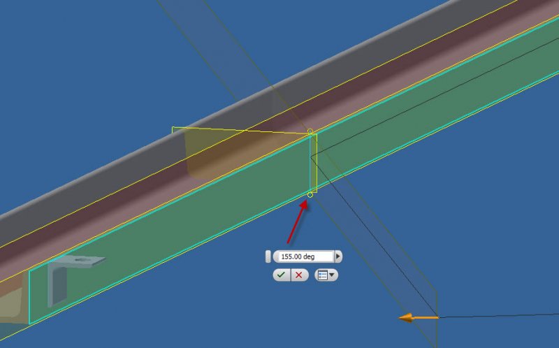

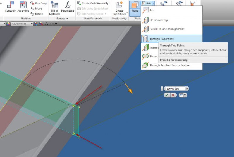

Well, you could add two points at the ends of your sketch line, then create an Axis between two points and then you will be able to create your angled plane.
how did you do that? it refused to snap to the endpoints of the line, so i couldn't put a point there, so i edited the sketch and made 2 points.
but still, when trying to make an axis line, it didn't snap to the points!

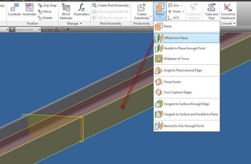

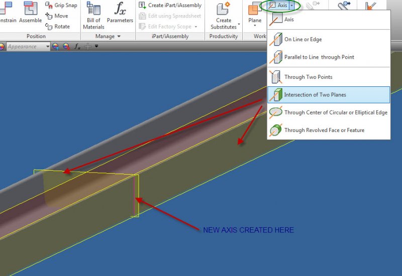

This might be an easier way to get your angled plane.
From your Assembly create an offset plane: (0.00) Offset
Create an Axis (Intersection of Two Planes)
Now create your angled plane off of the newly created Axis and select your angle.
