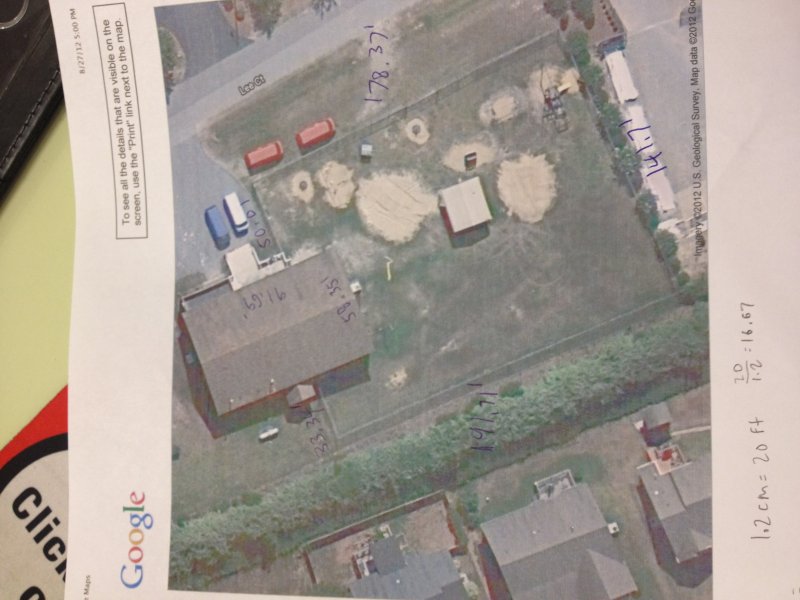

BobbyJonesNCSU Posted September 4, 2012 Share Posted September 4, 2012 I've never used AutoCAD before but I'm trying to make a site plan. I attached a picture of the property I'm trying to make a site plan of. Basically, it's a building that 59' by 92' that has a fenced in yard that is roughly a rectangle. I'd like to fit the site plan on regular 8.5"x11" sheet of paper. I know how to draw lines but don't know how to make them the right lengths. It doesn't need to be perfect with angles but I'd like to make it look nice with like a border and titles and such. I've been trying to read up on how to do it but I just get overwhelmed. Thank you so much in advance! Your help is greatly appreciated! Quote Link to comment Share on other sites More sharing options...

JD Mather Posted September 4, 2012 Share Posted September 4, 2012 (edited) I'd like to fit the site plan on regular 8.5"x11" sheet of paper. I know how to draw lines but don't know how to make them the right lengths. Draw it 1:1 - make the lines the same length they are in the real world. Then come back and ask how to make it fit on a A-Size sheet. Hmmm, someone else just asked the same question (or very similar) a week or so ago, but now I can't find the thread. Is this a school assignment? Do you want the surveyor's bearings or just a simple ortho size layout? If the former you might want to become familiar with Units. If the later then I would simply draw one rectangle for the building and one for the lot explode the lot rectangle and offset the right line towards the left and trim at top for the correct corner at the top left of lot. (I think you are missing one dimension - how far along the building does one of those two vertical lot lines start?) Doesn't need to be perfect. I would make it as perfect as the given information allows. Search here for modelspace and paperspace and templates for instructions on how to create a layout border. If you attach your dwg file of what you have attempted so far - I'm sure someone will walk you through the steps to completion. Edited September 4, 2012 by JD Mather Quote Link to comment Share on other sites More sharing options...

BobbyJonesNCSU Posted September 4, 2012 Author Share Posted September 4, 2012 Sorry, what are surveyor's bearings? I drew 2 rectangles but I don't know how make them 192' by 142' for the fenced in yard (and then I guess I got to explode and trim like you were saying) and 58' by 92' for the buidling. I attached the dwg file if that helps. SitePlan.dwg Quote Link to comment Share on other sites More sharing options...

rkent Posted September 4, 2012 Share Posted September 4, 2012 I would use the image in AutoCAD and trace everything I needed, then scale it to the correct size. If you have the image from google earth then you use the IMAGEATTACH command or from XREF pick on the upper left icon image and attach it in the drawing. Once in the drawing double click on the image border, a settings box should pop up, use the Fade and set it to 40 or 50%. Now you can draw right over the top of the image. When you have what you want you can unload the image through the XREF palette or simply erase it. If you go this route post back and someone will tell you how to scale it to proper size, although it may not be necessary for what you are doing. Quote Link to comment Share on other sites More sharing options...

ReMark Posted September 5, 2012 Share Posted September 5, 2012 "I'm kinda confused. Is that method how to create a site plan from the very start?" No it isn't. Tracing an image is nowhere near exact enough. Normally site plans are generated from surveys. Quote Link to comment Share on other sites More sharing options...
JD Mather Posted September 5, 2012 Share Posted September 5, 2012 The OP stated he as drawn it as accurately as needed. Taking this as "fact", the next step is to get it in a layout with border and appropriate scale and printed. Quote Link to comment Share on other sites More sharing options...
