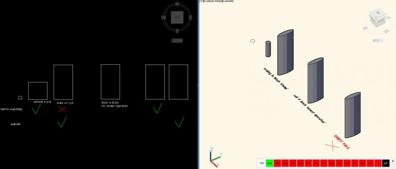

One type isyis blocks that have unequal scaled 3-D solids. At least until 2012. Probably later
*edit*edit*
Thanks for that insight. With EXNEST still no non-uniform blocks containing 3D SOLIDS can be handled, seems logic as it is result in very complex geometry calculations. In the current model i am working on (SAT origin from Inventor) there seem to be parts mirrored round different axis (parts with x=-1, y=-1, z=-1 and combinations), If i use AutoCAD burst command i seem only to explode if x=-1 (?), but EXNEST also explodes parts with z=-1 and y=-1 ? What is the logic behind this..
Anyway, this provides me some more knowlegde for scaling x,y,z and tracking problems with block containing a other value that 1 as scale. And wWhat is nice to know is that with other objects than 2D solids EXNEST can transform and exploded with this principle fine.. !
http://www.cadtutor.net/forum/showthread.php?98491-Scale-method-(alternative-for-block-inside-block-method)&highlight=sxyz
EXNEST FAILS.dwgFetching info...
Drawing2.dwgFetching info...
Edited by halam
It hasn't been that long ago when autocad finally figured out how explode most 2D entities properly. Last I checked it still had problems with ellipse entities.
In native 2D entities, all data is stored in the entity table database in numeric values.
Even this can be quit a complex mathematic calculation
Taken into consideration must be :
  • BLOCK'S Table's Insbase Point
  • INSERT Scale
  • INSERT UCS
  • INSERT Insertion Point
  • INSERT Rotation
Then for the entity:
  • Entity Type
  • Entity Points
  • Entity UCS
  • Entity Elevation
  • Entity Thickness
A non WCS ARC entity with thickness was always a gamble with explode. It had to be converted into a POLYLINE with bulges
With 3D solids, all of the geometry data is stored in binary format ( DXF Group 1 ). Extracting the numeric and form data would very difficult ( if not impossilbe ) to convert this into Acad's native entity information
Create a 3DSOLID and then at the command line type this
(entget (entlast))
1 possible work around would be if you can these 3D solids into meshes.
Mirrored BLOCKs are the easiest deal with. The X axis scale must be -1. So simply change all of the X axis values from positive to negative or vice versa. Maybe they figured out how to do this the Y and or Z axis.
HTH -David
"simply change all of the X axis values from positive to negative or vice versa".
That is a way to deal with it, but it might have an impact on the workload / proces if you have large quantities of parts in a DWG files
I'm thinking their should be a smarter way, to get mirrored (copies!) of a 3D block, but this is getting off-topic
(off-topic: did some import / export of 3D DWG blocks)
I did some checking how these x,y,z values as i was thinking this might be 'hurtfull' in other applications to import
Was supprised this x,y,z translated pretty good for Sketchup and Allplan, even after exporting it to IFC.
But AutoCAD 'Surface' and 'Mesh' are not translated.. (I'm starting with DWG geometry coming from Inventor)
When i convert this _MESHSMOOTH ..EXPLODE mesh to 3DFACES
.. exports now 'good'.. now i'm looking for a routine to explode surfaces.)
screnshot surface not translated.zipFetching info...
