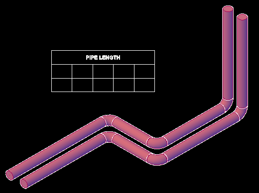

Faouweb Posted September 3, 2012 Posted September 3, 2012 Hi, How can i create a bill of materials or table with all pipe lenght in AutoCAD MEP 2011? Thank you Quote

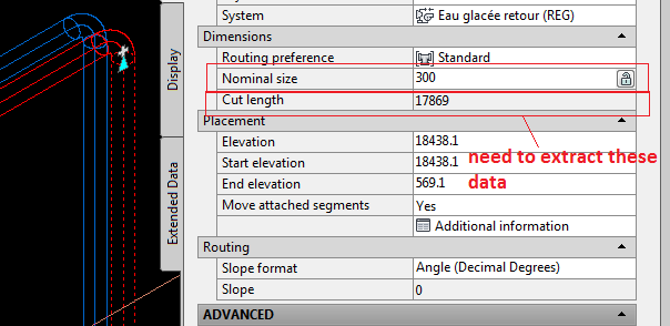

Faouweb Posted September 4, 2012 Author Posted September 4, 2012 I have tried with DATA EXTRACTION and i have a lot of data , but what I need now is Nominal size it's not in the Data extraction's liste . How can I get Nominal size data tp put it in a table? Thank you Quote

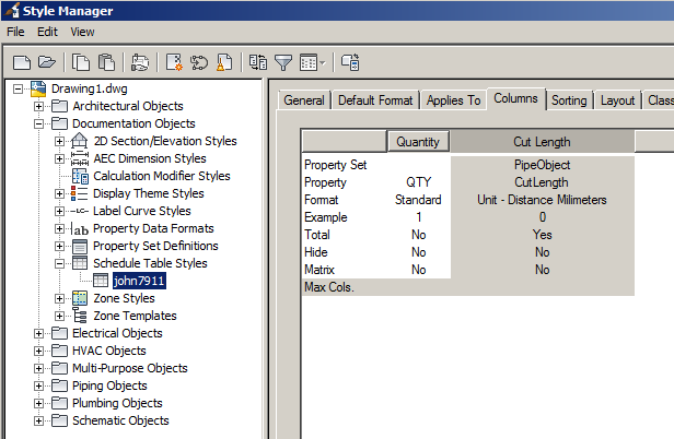

tzframpton Posted September 4, 2012 Posted September 4, 2012 Go to you Style Manager. Under Schedule Table Styles, create a new schedule. Once you have this schedule selected, under the "Applies To" tab, check "Pipe". Then in the Columns tab, towards the bottom of the dialog you'll see a "Include Quantity Column". Check this. Now click the "Add Column" button and under PipeObject, select "CutLength" and check the "Total" box to the right, then click OK. Click OK again to exit. You now have a schedule made. Now apply an AEC Schedule and select all your objects, then place the schedule. Once you do, right-click the schedule and click "Add All Property Sets" to apply the necessary information to that schedule, then it'll auto-populate. Once you make any changes to those objects, or start to add/delete objects, the schedule will show a diagonal line across it. You'll have to right-click the schedule, click "Selection > Reselect" to grab the changes. Then you usually have to repeat the "Add All Property Sets" command if there's any new objects that didn't exist before. Quote
Faouweb Posted September 4, 2012 Author Posted September 4, 2012 Thank you StykFacE for your help The first part is OK I have created a new schedule, but the second part I don't know how to apply an AEC Schedule Quote
tzframpton Posted September 4, 2012 Posted September 4, 2012 type AECSCHEDULEADD at the command line, or go to the Annotate Tab under Scheduling. AutoCAD MEP has "default schedules" for whatever dumb reason, just pick which ever one and before you select anything, change the Schedule in the Properties Palette. Quote

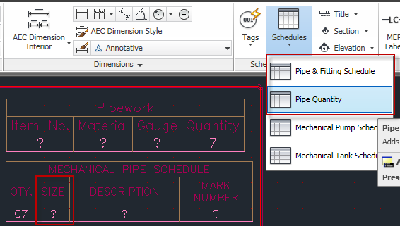

Faouweb Posted September 4, 2012 Author Posted September 4, 2012 Dear StykFacE sorry to bother you with an other question I have some question mark on the cell as you can see on the picture. Quote
tzframpton Posted September 4, 2012 Posted September 4, 2012 Did you follow my steps for adding all property sets? And are you using the schedule style you made or a default one? Make sure all the columns have the proper property set data. Quote

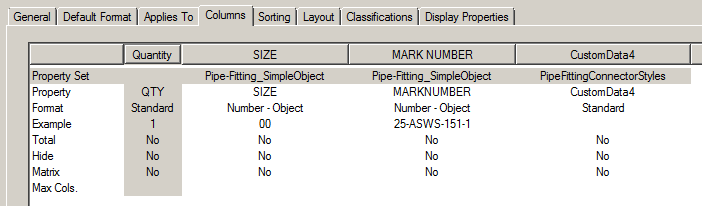

Faouweb Posted September 12, 2012 Author Posted September 12, 2012 I want to creat a table with all quantity of fittings that i need for the project, for example: flange: 15 - Elbow: 12 - reducer: 4 ... Quote
tzframpton Posted September 12, 2012 Posted September 12, 2012 Just Copy/Paste any existing schedule you have right now in the Style Manager. When you Paste it, it'll simply "duplicate" it with a (2) behind it. From there, rename it and go to the "Applies To" tab and change from Pipe to Pipe Fittings, then that particular table will only pick up fittings. Make sure, of course, in your Columns tab that you select the proper Property Set. If you're wanting to leverage this BOM data in Excel, you know you can right-click any schedule and Export as an Excel file, correct? Quote

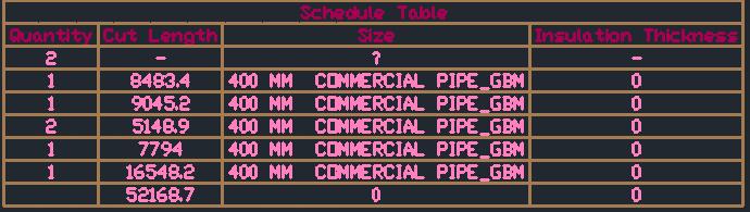

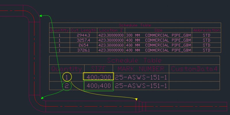

Faouweb Posted September 13, 2012 Author Posted September 13, 2012 Hi, This is the result: Is it OK ? for Elbow i have 400;400 - Reducer 400;300 - and if i have a Tee 400;400;400 Quote
tzframpton Posted September 13, 2012 Posted September 13, 2012 Add the correct Property Set to a new column that puts the description of the fittings in there. That's my preference, anyways. So far looks good though! Quote
