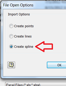

What is the nature of the design (civil, architectural, mechanical)?
If Mechanical - Autodesk Inventor product has built-in functionality to create spline from Excel.

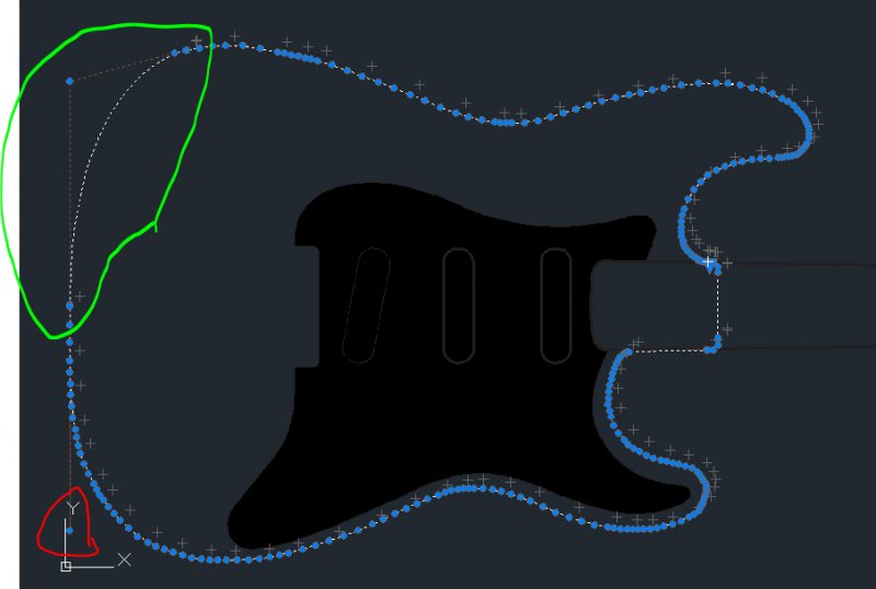

If you must do the work in AutoCAD - search Google for a lisp routine that will create the spline. Somehow I attached wrong image and can't delete it below.
