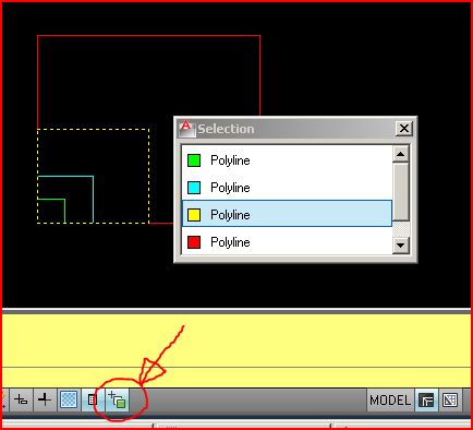

Dadgad Posted September 3, 2012 Posted September 3, 2012 I shouldn't think that it would matter that it was from another program. I could be wrong about that. The image shows what I mean by selection cycling. Having started a command, then selected at an ambiguous point, because there are 4 polylines on top of one another, you are presented with a dropdown selection box. You can turn it on and off by clicking on the circled icon, or CTRL+W. The blue highlighted one is the one that the software has guessed you mean to select, and if it is correct, just hit enter. If it is wrong then you need to select the correct one from the list before hitting enter. Right click on the status bar icon to change the settings of the tool. Quote

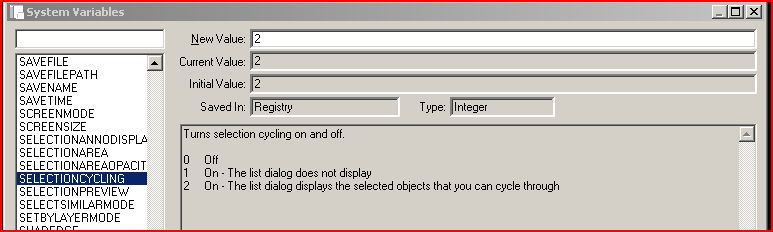

Dadgad Posted September 3, 2012 Posted September 3, 2012 Yeah, too bad, probably added later, but just in case, look at this, never say never. Quote
