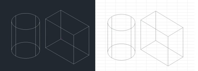

mikeklon Posted August 31, 2012 Share Posted August 31, 2012 Hello, I am attempting to copy and paste a part of a drawing from AutoCAD 2011 into ms, Excel or Word. I am able to copy within a vport so my whole screen is not copied. My problem is only 2D objects show up when I paste. I tried different visual styles and colors but still cant get my solid objects to appear. Is there an options setting I am missing? Please Help. Mike Quote Link to comment Share on other sites More sharing options...

SuperCAD Posted September 2, 2012 Share Posted September 2, 2012 You can use the "PublishToWeb JPG" plotter driver and then insert the image into Excel. I've used this before when including images in our CAD standards manual and it worked pretty good. Here is a more detailed description of how to get an image file from AutoCAD: http://www.ellenfinkelstein.com/acadblog/creating-jpeg-and-png-files/ Quote Link to comment Share on other sites More sharing options...
dedmin Posted September 2, 2012 Share Posted September 2, 2012 Try wmfout to get vectors in Excel Quote Link to comment Share on other sites More sharing options...
mikeklon Posted September 3, 2012 Author Share Posted September 3, 2012 Command: JPGOUT did what I was looking for. Thanks Quote Link to comment Share on other sites More sharing options...
MSasu Posted September 3, 2012 Share Posted September 3, 2012 My two cents would go for WMF format since this allow better control over scale of the image. One addition, if decide to try this command don't forget about WMFBKGND system variable which prevent export of the background color. Quote Link to comment Share on other sites More sharing options...
mikeklon Posted September 5, 2012 Author Share Posted September 5, 2012 Using WMFOUT, I was unable to get a realistic image. Only, 3D wireframe. When using JPGOUT, it provides me with a realistic visual style. Although, the image has poor resolution. Is it possible to output an image with the same quality resolution you get as when you exprort a PDF file? Or, Is there a way to edit the PDF export. Just the text on the PDF not the image. Quote Link to comment Share on other sites More sharing options...
