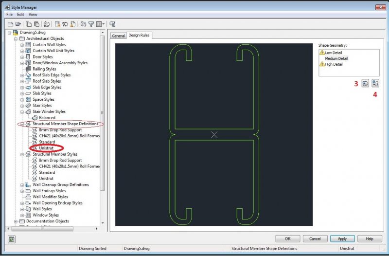

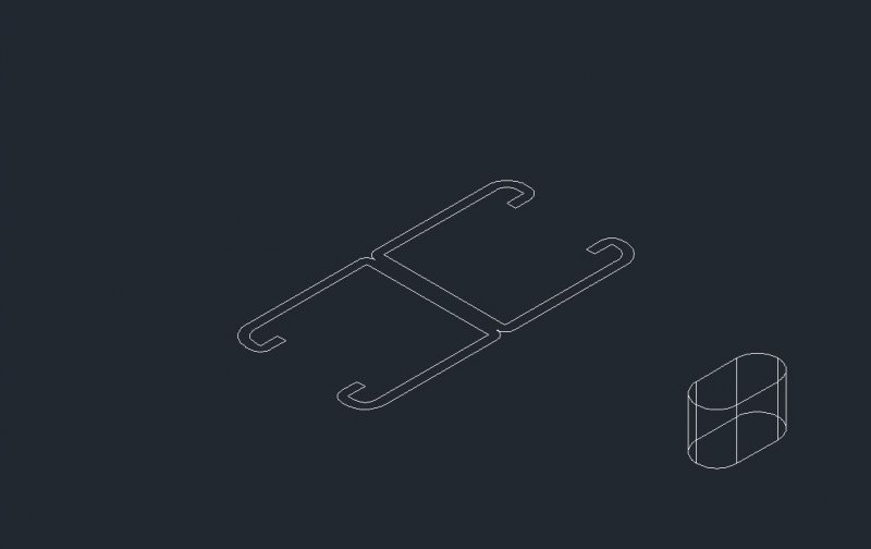

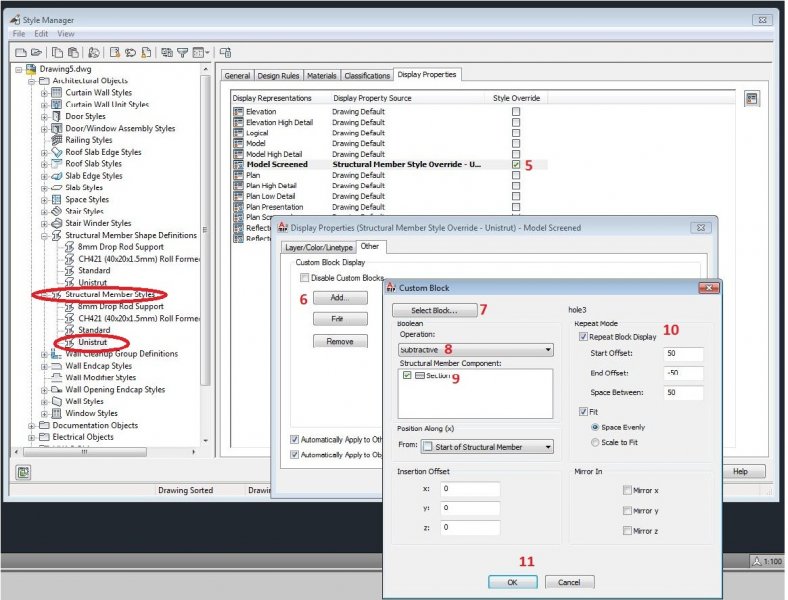

hoss Posted October 4, 2012 Share Posted October 4, 2012 I am not sure how, he (StykFacE) has done his, but this is the way I manage to do it (not sure if it is as good). He explained the subtraction of the hole in the thread he shared Unistrut. First of all you need to draw a cross section of the Unistrut (you can draw a back to back one, so it becomes one object) or just one like StykFacE. It has to be a closed polyline. You also need to draw the hole and extrude it and create a block which you will use later Quote Link to comment Share on other sites More sharing options...

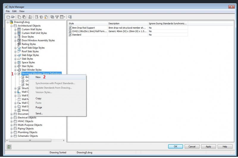

tzframpton Posted October 4, 2012 Share Posted October 4, 2012 Second image, #3 is how you change the profile. Just make sure it's a closed polyline. Or, create a new style, as you've shown in the first image #1 & 2. Good work hoss!! Thanks for backing me up. Glad to see some MEP guys getting more involved in here. Quote Link to comment Share on other sites More sharing options...
