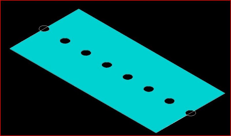

Actaully there is a plate with holes(arrayed), needs to be bent like cylinder as shown in the image.

If you need to model it flat, you could do it like this.....
Command: RECTANG
Specify first corner point or [Chamfer/Elevation/Fillet/Thickness/Width]:
Specify other corner point or [Area/Dimensions/Rotation]:
Command: CIRCLE
CIRCLE Specify center point for circle or [3P/2P/Ttr (tan tan radius)]:
Specify radius of circle or [Diameter]:
Command: COPY
Select objects: 1 found
Select objects:
Current settings: Copy mode = Multiple
Specify base point or [Displacement/mOde] : o
Enter a copy mode option [single/Multiple] : m
Specify second point or [Array] : a
Enter number of items to array: 8
Specify second point or [Fit]: f
Specify second point or [Array]:
Command: _-view Enter an option
[?/Delete/Orthographic/Restore/Save/sEttings/Window]: _seiso Regenerating model.
Command: ppp
PRESSPULL
Click inside bounded areas to press or pull:
6 loops extracted.
6 Regions created.
1 loop extracted.
1 Region created.
Select solids, surfaces, and regions to subtract from ..
Subtracting inner regions...
2
Command: _vscurrent
Enter an option
[2dwireframe/Wireframe/Hidden/Realistic/Conceptual/Shaded/shaded with
Edges/shades of Gray/SKetchy/X-ray/Other] : _R
Thanks for this quick reply,
The problem still remains. I made a plate, Drilled holes. I want to Bend it.
How to bend it? please refer the image posted by ReMark. That kind of bend.

thanks for the detailed steps.
You cannot bend it to shape in Autocad, to the best of my knowledge.
INVENTOR has tools for working with SHEET METAL which will do it.
ReMark did not BEND it, he modeled it that way, if you check you will see that there is no seam where edges would need to be joined.
If you are going to do it in Autocad I believe you will have to do it in its completed configuration.
While you cannot start with your flat modeled piece of plate and bend it into its final shape, you can model it directly
in the finished shape, displaying the gap at the seam, as if it had been bent into that shape.

You will need Autodesk Inventor to make that part correctly.
You can get close in AutoCAD by
creating a circle something like 359.9° at desired inside or outside radius.
Extrude as a surface body.
Create circle for hole.
Trim the surface body with the hole (array as needed). (this is not technically correct as the circle would distort as the part is bent)
Thicken the surface body into a solid. (creating the cylinder as a solid and subtracting cylinder for holes would result in incorrect sidewalls of holes)
How precise do you need this result?
AutoCAD has no way of calculating Bend Allowance.
When a material is bent it stretches on the outside of the bend and compresses in the inside radius.
The neutral plane (no stretch or compression) is not necessarily at the midplane of the thickness (in fact, usually not).
The Bend Allowance is dependent on material, thickness, inside radius and angle of bend.
The Machinery's Handbook as formulas for manual calculation.
Autodesk Inventor will calculate Bend Allowance for you (and do the geometry correctly).

This question comes up quite frequently on the Inventor Forums - there is still a bit of a trick to get the holes correct if you arn't familiar with sheet metal processes.
They can be round in the flat or the bent part - but not both. You have to make a decision if you want round in the flat (less expensive) and allow clearance or round in the bent part (more expensive) and design the eliptical punches that would result in flat forming to round.
