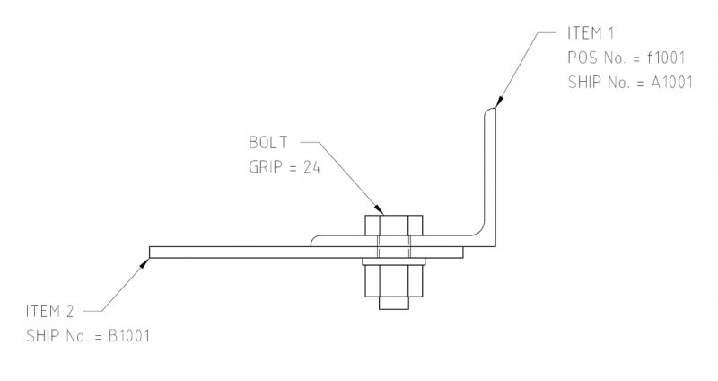

lamensterms Posted August 30, 2012 Share Posted August 30, 2012 Hi guys, I've been planning to teach myself how to use LISP with ProSteel, unfortunately there are few resources to learn - and I havent had too much spare time in which I can study it. I was just wondering if I could please get some input and help putting together a routine which would read and write data attached to ProSteel entities. For those who are familiar with ProSteel... The idea is quite simple... I would like to fill in the "NOTE 2" field with a string compiled from the "SHIP No." and "POS No." fields - as well as fill in the "POS No." field with the "GRIP LENGTH" field. The application is for labeling bolts with the information as to what items they are bolting together. Example (Please see attached JPEG)... There is a bolt which connects "ITEM 1" to "ITEM 2" Item 1 Data POS No. = f1001 SHIP No. = A1001 Item 2 Data SHIP No. = B1001 Bolt Data GRIP LENGTH = 24 I would like to be able to extract the "SHIP No." and the "POS No." from "ITEM 1" as well as the "SHIP No." from "ITEM 2" and compile it into a string, and place that string into the "NOTE 2" field of the bolt. I would also like to transfer the "GRIP LENGTH" value from the bolt and put it into the "POS No." field of the bolt. Bolt Data NOTE 2 = "ITEM 1 SHIP No." ("ITEM 1 POS No.") TO "ITEM 2 SHIP No." = A1001 (f1001) TO B1001 POS No. = GRIP LENGTH = 24 This would ideally be achieved by selecting the bolts first, then picking "ITEM 1", then picking "ITEM 2". Thank you all very much for all your help. Cheers Quote Link to comment Share on other sites More sharing options...

lamensterms Posted September 4, 2012 Author Share Posted September 4, 2012 Awesome, thanks a lot Carry. ;----------------------------------------------------------------------------- ; MAIN PROGRAM ;----------------------------------------------------------------------------- ;--------------------------Read Data From Item 1------------------------------ (defun c:abd (/ acadapp shapeinfo ent ent1 Note1s1 Note2s1 ShipNumberS1 PosNumberS1 ent2 ent2A ent2B ShipNumberS2 ent3 ent3A ent3B GRIP LOCATION vObje con num) (vl-load-com) (setq acadapp (vlax-get-acad-object)) (setq shapeinfo (vla-getinterfaceobject acadapp "PSCOMWRAPPER.Ks_ComShapeInfo")) (setq ent (entsel "\nSelect 1 shape: ")) (setq ent (car ent)) (setq ent1 ent) (vlax-invoke-method shapeinfo 'setobject (vlax-ename->vla-object ent)) (vlax-invoke-method shapeinfo 'getinfo);ritrova le informazioni nel database (setq shapeinfo (vla-getinterfaceobject acadApp "PSCOMWRAPPER.Ks_ComShape")) (setq shapeinfo (vlax-ename->vla-object ent1)) (setq Note1s1 (vlax-get-property shapeinfo 'Note1)) ;Note1shape1 (setq Note2s1 (vlax-get-property shapeinfo 'Note2)) ;Note2shape1 (setq ShipNumberS1 (vlax-get-property shapeinfo 'ShipNumber)) ;shape1 (setq PosNumberS1 (vlax-get-property shapeinfo 'PosNumber)) ;shape1 (vlax-release-object shapeinfo) (setq shapeinfo nil) (setq acadApp nil)(princ) ;***************************************************************************** ;--------------------------Read Data From Item 2------------------------------ (setq acadapp (vlax-get-acad-object)) (setq shapeinfo (vla-getinterfaceobject acadapp "PSCOMWRAPPER.Ks_ComShapeInfo")) (setq ent2 (entsel "\nSelect 2 shape: ")) (setq ent2A (car ent2)) (setq ent2B ent2A) (vlax-invoke-method shapeinfo 'setobject (vlax-ename->vla-object ent2A)) (vlax-invoke-method shapeinfo 'getinfo);ritrova le informazioni nel database (setq shapeinfo (vla-getinterfaceobject acadApp "PSCOMWRAPPER.Ks_ComShape")) (setq shapeinfo (vlax-ename->vla-object ent2B)) (setq ShipNumberS2 (vlax-get-property shapeinfo 'ShipNumber)) ;Ship Number Shape 2 (vlax-release-object shapeinfo) (setq shapeinfo nil) (setq acadApp nil)(princ) ;***************************************************************************** ;--------------------------Read Data From Bolt-------------------------------- (prompt "\nSelect BOLT:")(princ) (setq ss (ssget '((0 . "KS_BOLT"))));8=Name Layer 0=ks_object (setq num (sslength ss));n° object (setq con 0) (repeat num (setq ent3A (ssname ss con)) ; (entsel "\nSelect BOLT: ")) (setq ent3B ent3A) (setq acadapp (vlax-get-acad-object)) (setq shapeinfo (vla-getinterfaceobject acadapp "PSCOMWRAPPER.Ks_ComShapeInfo")) (vlax-invoke-method shapeinfo 'setobject (vlax-ename->vla-object ent3A)) (vlax-invoke-method shapeinfo 'getinfo);ritrova le informazioni nel database (setq shapeinfo (vla-getinterfaceobject acadApp "PSCOMWRAPPER.Ks_ComShape")) (setq shapeinfo (vlax-ename->vla-object ent3B)) (setq GRIP (vlax-get-property shapeinfo 'KlemmLength)) ;Bolt Grip (vlax-release-object shapeinfo) (setq shapeinfo nil) (setq acadApp nil)(princ) (setq con (1+ con)) ;***************************************************************************** ;--------------------------Write Data To Bolt--------------------------------- (setq LOCATION (strcat ShipNumberS1 " (" PosNumberS1") TO "ShipNumberS2)); 10 ( 1 (setq vObje (vlax-ename->vla-object ent3a));Bolt (vlax-put-property vObje 'PosNumber GRIP) (vlax-put-property vObje 'Note2 LOCATION) (vlax-put-property vObje 'ShipNumber ShipNumberS1) ) ) (print "Type ABD to run") Quote Link to comment Share on other sites More sharing options...

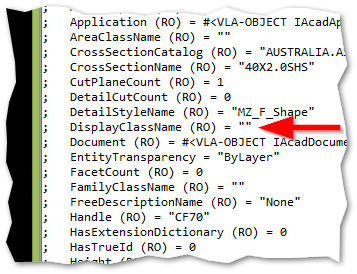

bra888 Posted May 11, 2021 Share Posted May 11, 2021 hi all i tried the following codes (defun c:itemProperty ( ) (vl-load-com) (setq acadapp (vlax-get-acad-object)) (setq shapeinfo (vla-getinterfaceobject acadapp "PSCOMWRAPPER.Ks_ComShapeInfo" )) (setq ent (entsel "\nSelect group: " )) (setq ent (car ent)) (vlax-invoke-method shapeinfo 'setobject (vlax-ename->vla-object ent)) (vlax-invoke-method shapeinfo 'getinfo); (setq shapeinfo (vla-getinterfaceobject acadapp "PSCOMWRAPPER.Ks_ComShape" )) (setq shapeinfo (vlax-ename->vla-object ent)) (setq Note1 (vlax-get-property shapeinfo 'Note1)) (princ Note1 ) (princ "\n") (setq vObje (vlax-ename->vla-object ent)) (vlax-put-property vObje 'Note1 "TESTx") ;(princ (strcat (rtos count 2 0) " - " name)) (princ) ) and i am able to extract the Note1 of an object and overwrite with "TEXTx" However when I tried (defun c:itemProperty ( ) (vl-load-com) (setq acadapp (vlax-get-acad-object)) (setq shapeinfo (vla-getinterfaceobject acadapp "PSCOMWRAPPER.Ks_ComShapeInfo" )) (setq ent (entsel "\nSelect group: " )) (setq ent (car ent)) (vlax-invoke-method shapeinfo 'setobject (vlax-ename->vla-object ent)) (vlax-invoke-method shapeinfo 'getinfo); (setq shapeinfo (vla-getinterfaceobject acadapp "PSCOMWRAPPER.Ks_ComShape" )) (setq shapeinfo (vlax-ename->vla-object ent)) (setq dc (vlax-get-property shapeinfo 'DisplayClassName)) (princ dc ) (princ "\n") (setq vObje (vlax-ename->vla-object ent)) (vlax-put-property vObje 'DisplayClassName "Bolts") ;(princ (strcat (rtos count 2 0) " - " name)) (princ) ) i am able to extract the display class name of an object, but unable to overwrite/assign the display class Is there something I am missing? Please help. Quote Link to comment Share on other sites More sharing options...
lamensterms Posted May 12, 2021 Author Share Posted May 12, 2021 Hi bra888, Unfortunately there are some fields which are read-only, and cannot be written to outside of the ProSteel functions. You can use the routine below, to get a list of each field, value and also shows a read-only flag "(RO)". Credit to BIGAL for Dumpit.LSP. ;;; Dump all methods and properties for selected objects ; ;;;===================================================================; ;;; DumpIt ; ;;;-------------------------------------------------------------------; ;;;===================================================================; (defun C:DumpIt ( / ent) ;(while (setq ent (entsel)) (vlax-Dump-Object (vlax-Ename->Vla-Object (car ent)) ) ;) (textscr) (princ) ) Using the above routine, you can see that Display Class is read only: Quote Link to comment Share on other sites More sharing options...
bra888 Posted May 12, 2021 Share Posted May 12, 2021 hi lamensterms thanks for your reply. That is good to know otherwise I will be endlessly stuck in this method. is there any other way to assign display classes using lisp? Or does it require a different computer language? Quote Link to comment Share on other sites More sharing options...
lamensterms Posted May 16, 2021 Author Share Posted May 16, 2021 Not that I'm aware of, it's beyond my LISP ability. To assign Display Classes, I use a combination of 2D Detail Centre + the Display Class tool. Are they not useful to you? Quote Link to comment Share on other sites More sharing options...
devitg Posted May 18, 2021 Share Posted May 18, 2021 On 5/12/2021 at 1:16 PM, bra888 said: hi lamensterms thanks for your reply. That is good to know otherwise I will be endlessly stuck in this method. is there any other way to assign display classes using lisp? Or does it require a different computer language? this variable hold the classname (setq dc (vlax-get-property shapeinfo 'DisplayClassName)) I guess, I have not prosteel you can read only , not change Quote Link to comment Share on other sites More sharing options...
