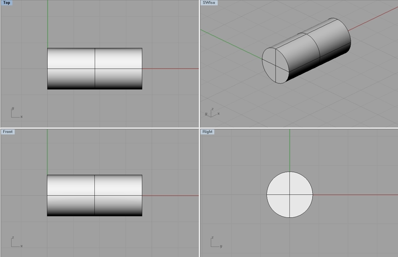

Here is a different file with the same problem (this one is a simple cylinder). I have exported it as a STEP and zipped it.
untitled.stp.zip
I guess it is not a geometry thing. The STEP file imports and renders in the viewports okay over here.
On your setup, are there some files that do render correctly, and others that do not?
No, I can't get anything to show as anything other than wire frame in "real-time". And all view ports are the same. It started this right off the bat. I did the "flash light" tutorial and the second step is to turn the perspective view port on "ghosted". When I tried that, I got no change. I do get some change when I try to set the view port on "render", but what it does is to turn invisible. If I tell it to show the wire lines, etc., I see the object as if it were wire frame, if I turn them all off, I see nothing.
