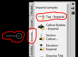

ReMark Posted August 29, 2012 Posted August 29, 2012 Tool Palettes > Annotation tab > Tag - Imperial. Why reinvent the wheel? Quote

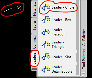

ReMark Posted August 29, 2012 Posted August 29, 2012 Or how about Tool Palettes > Leaders > Leader - Circle. Each block I have mentioned is "dynamic" too. Quote
084x4larry Posted August 30, 2012 Author Posted August 30, 2012 [ATTACH=CONFIG]36834[/ATTACH]Or how about Tool Palettes > Leaders > Leader - Circle. Each block I have mentioned is "dynamic" too. yeah those have a number of issues that dont work for my particular application (one being i cannot have the landing before the cirlce and another being the text font) the place i used to work had a really nice lisp routine that worked very well but my new work place does not have it. i know there are a lot of people out there who are extremely skilled with writing lisp who may be able to hook me up. just hoping one will read my thread. Quote
