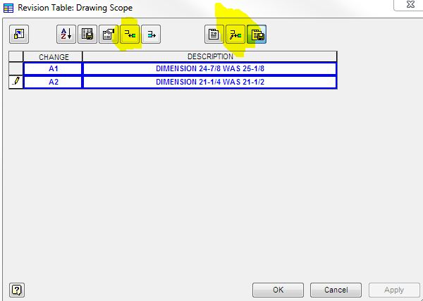

Which button did you use to add rows to your rev table?
I suspect you'll find a clear correlation between which button you used to add the row, and which rows are getting their number changed.
Thank you Bishop. I have never noticed the difference between the two options before.
