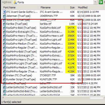

There's this font called Kozuka (with a Gothic and Mincho version) installed on my PC. As far as I know, it got installed through some Adobe application.

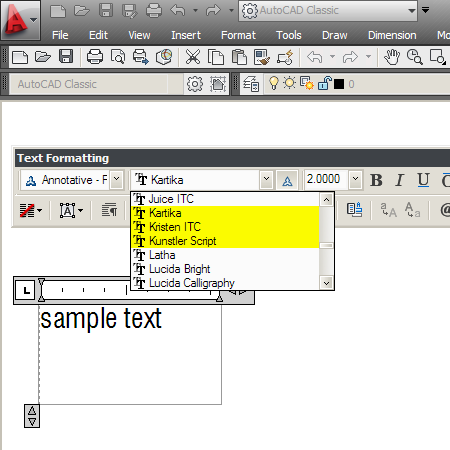

Now, the problem is that I can use it in all the Windows applications but not in AutoCAD, where the MTEXT window doesn't list the font.
Interestingly, this font is quite heavy, with a file size of over 3.5MB but then there are others too which fall in this "heavy-weight category" but are displayed in AutoCAD without any issues. :geek:
From the screen-shot of your fonts collection seems that the said trouble-maker font is in fact an OTF (Open Type Font) type and not a TTF (True Type Font) one. I'm pretty sure that OTF type weren't supported in AutoCAD 2008.
After some research, seems that by changing the extension to TTF, some OTF fonts may be recognised by AutoCAD. If decide to try this, don't forget to do it on a copy, for sure.

Didn't work for me, though! :oops: But never mind, I used Corel instead (it supports OTF fonts)!
