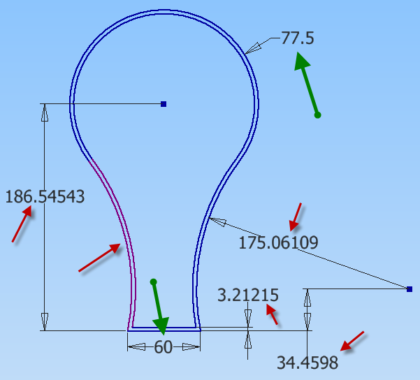

JD Mather Posted August 30, 2012 Posted August 30, 2012 (edited) Starting from a solid foundation is the first step in creating anything. Notice that when I dimension your sketch only two of the dimensions make logical sense - and for some reason you deleted these? Notice that the sketch appears that you had symmetry in mind - but when I apply all of the dimensions that should be needed - one side is not fully constrained. For some reason I am always reluctant to move on to the real problem when the evidence indicates that foundation principles are not understood. Perhaps it is because in my experience those who ignore the foundation principles never grasp the more complex techniques. Edited September 2, 2012 by JD Mather Quote

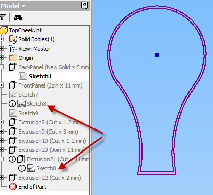

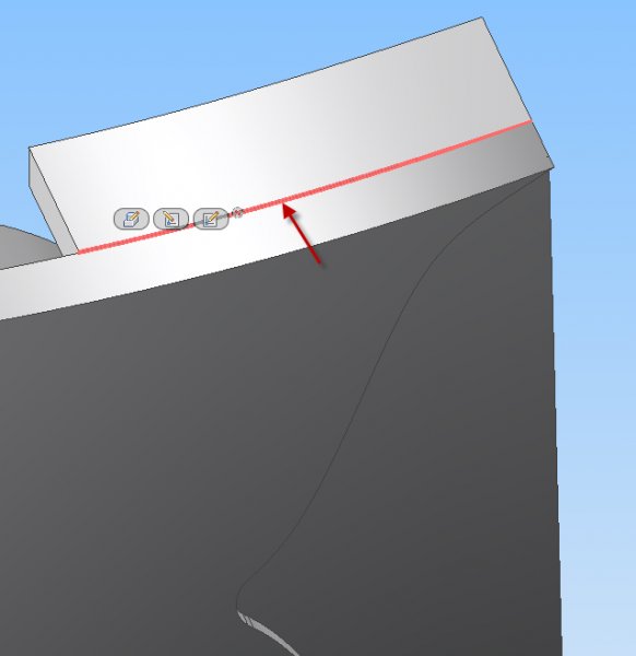

JD Mather Posted August 30, 2012 Posted August 30, 2012 (edited) What is the purpose of Sketch7? There is nothing in it? What is the purpose of Sketch9? There is nothing in it? Didn't you intend for both fillets in PadPocketOutside sketch to be Tangent? Didn't you intend for both fillets in PadPocketInside sketch to be Tangent? Did you intend for the fillet in HingePlate sketch to be Tangent? Did you intend for this tiny sliver of material? If, so how come it is not there on the other side of what looks like was supposed to be a symmetrical feature (in fact it cuts in a tiny amount on the other side). Dimensioning and symmetry constraints solves these problems. The principles of robust modeling are the same for any CAD program. The GIGO principle applies. Just the facts of the case the way I see it. Edited August 30, 2012 by JD Mather Quote
