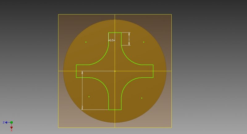

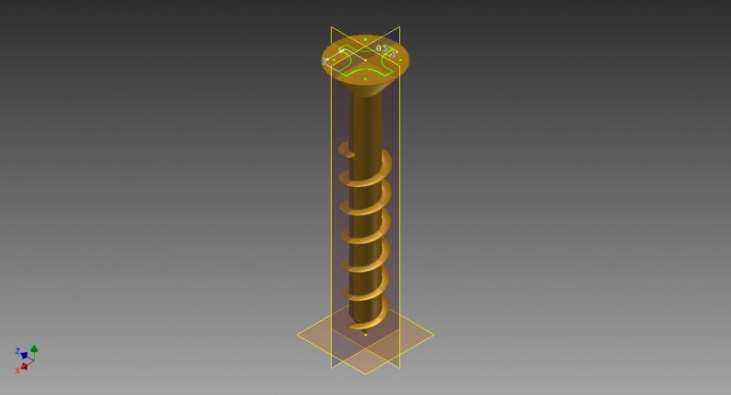

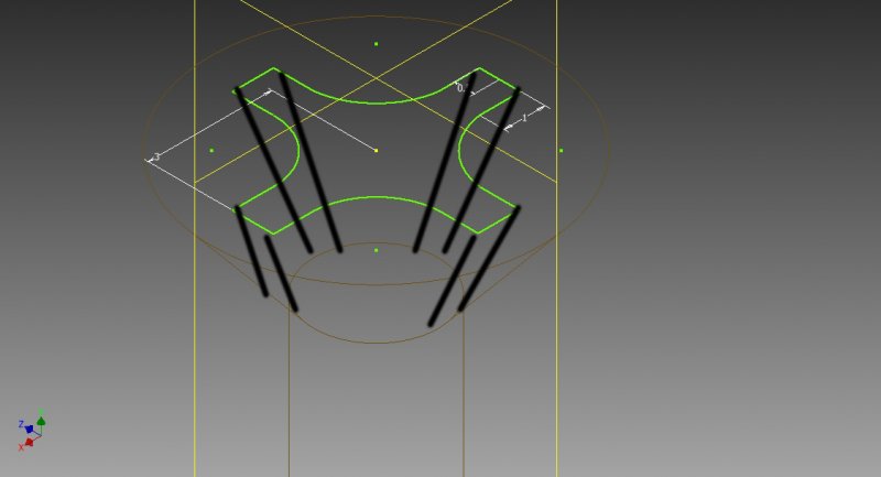

how do u make a Philips head screw shape
hello im am a newbie and i was just wandering how do i cut a screw face of Philips head as a angle so it will be right with the bottom part
i have attached 3 images below if you dont understand what i am trying to say please ask thanks

If i were doing this in Autocad, I might OFFSET it, adjust the elevation and LOFT then subtract.
No doubt INVENTOR will have a custom function for philips head slot relief. :beer:

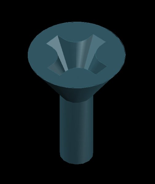

I vote for the use of the LOFT command.
For demonstration purposes only. No real dimensions were used in the creation of this object.
JDM will probably find ten things wrong with this 3D model. LoL
Edited by ReMark
Extrude with Taper.
