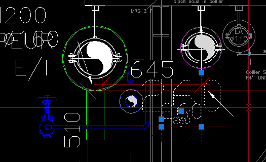

Faouweb Posted August 24, 2012 Share Posted August 24, 2012 Hi, I have different annotative dimenssion on my drawing, when I select one all others dimession show up as you can see on the picture (260 three times ). Is there any solution to select dimenssion or text without showing other scale? Thank you Quote Link to comment Share on other sites More sharing options...

rkent Posted August 24, 2012 Share Posted August 24, 2012 (edited) john7911 - try SELECTIONANNODISPLAY, it is easier to find system variables now with autocomplete on, as an example, I typed at the command line *anno* and looked for one in the list that might be promising. Edited August 24, 2012 by rkent Quote Link to comment Share on other sites More sharing options...
Faouweb Posted August 24, 2012 Author Share Posted August 24, 2012 Thaaaaaaaaaaank you rkent GREAT COMMAND Quote Link to comment Share on other sites More sharing options...
